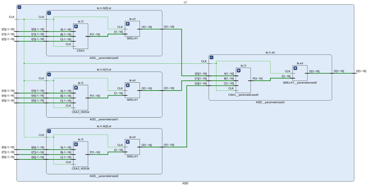

As an example here is how the synthesis result for a 9-input adder tree with LATENCY=2 looks like this:
In conclusion, we have created a recursive module for an adder tree that uses mostly 3-input Carry Save Adders and for large trees requires about 50% of the number of LUT6es of a naive behavioral implementation. If pipelined properly with a minimum latency of LOG3(N) it can run at speeds of over 800MHz for any value of N.
