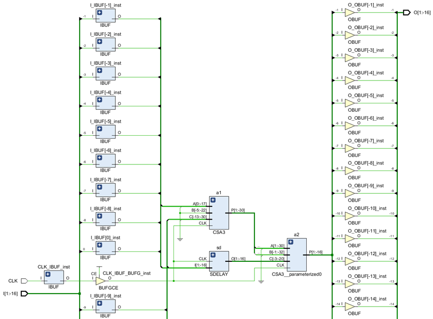

If I is the variable input and O is the output, we can compute the KCM O<=sqrt(0.5)*I with only two 3-input adders using an intermediate result X:
X<=SHIFT_RIGHT(I,1)+SHIFT_RIGHT(I,6)+SHIFT_RIGHT(I,14)
O<=X+SHIFT_RIGHT(X,2)+SHIFT_RIGHT(I,4)
We can reuse now the CSA3 module created earlier and write the KCM in VHDL very easily:

Note again the use of the arbitrary fixed point precision unconstrained SFIXED type, this module will multiply a signed fixed point input I of any range by 46341/65536 and then truncate the result to the arbitrary range specified by O. With the PIPELINE generic we can have either a purely combinatorial implementation or one with a latency of 2 clocks which will run easily at speeds in the 800MHz range.  Here is the synthesis result when the I and O ports have both a SFIXED(1 downto -16) range and PIPELINED is TRUE:
