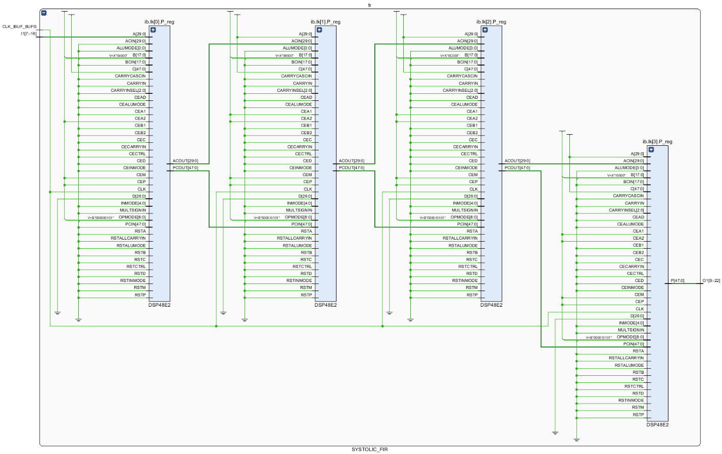

While the coefficients are constants right now, the top level design could very well implement variable coefficients with no changes to the SYSTOLIC_FIR generic building block. I kept the filter size short, only 4 taps so we can look at the implementation results in schematic form:
This confirms that there are no fabric logic or routing resources used other than DSP48s and dedicated A and P cascade routing and the filter will scale up to larger N values without a degradation in speed. As a general rule, Vivado synthesis will infer properly pipelined FIRs, including symmetric ones with the use of the pre-adder which will be the object of the next post, from behavioral HDL but only if a particular coding style is followed.
