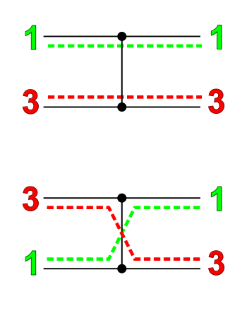

Sorting networks are defined in terms of a Compare and Exchange basic building block:

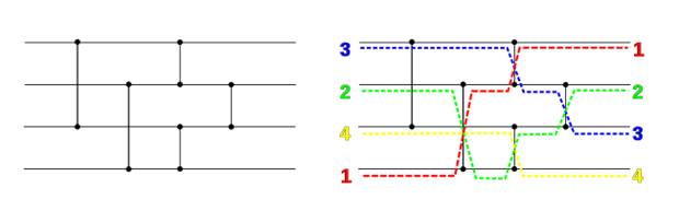

This block has two inputs and two outputs and the block compares the two inputs and swaps them if they are not in order, all in a single operation, then the results are passed to the outputs. Data moves from left to right and each pair of dots connected with a vertical bar represents a compare-exchange block. We can say that a compare-exchange block is a sorting network of size 2. In hardware terms it consists of a comparator and two 2:1 muxes, where the select input of the two muxes is driven by the output of the comparator. Larger sorting networks can be built out of multiple compare-exchange blocks connected properly. Here is an example of a sorting network for N=4, it has size 5 and depth 3:
