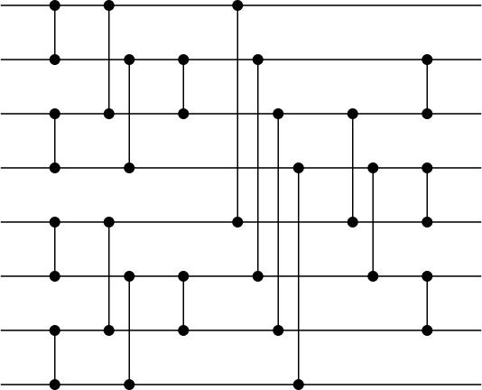

The Wikipedia page provides an example of a Batcher sorting network for N=8:
The left half of the diagram is made up of the two mergesort(N/2) calls and the right half is the recursive merge(N) call. The two smaller mergesorts are each one decomposed into two mergesort(N/4) followed by a merge(N/2). The merge(N) itself is made out of two merge(N/2) interleaved, followed by N/2-1 comp_exch blocks and the two merge(N/2) are also recursively defined in terms of two merge(N/4) and one comp_exch block each.
