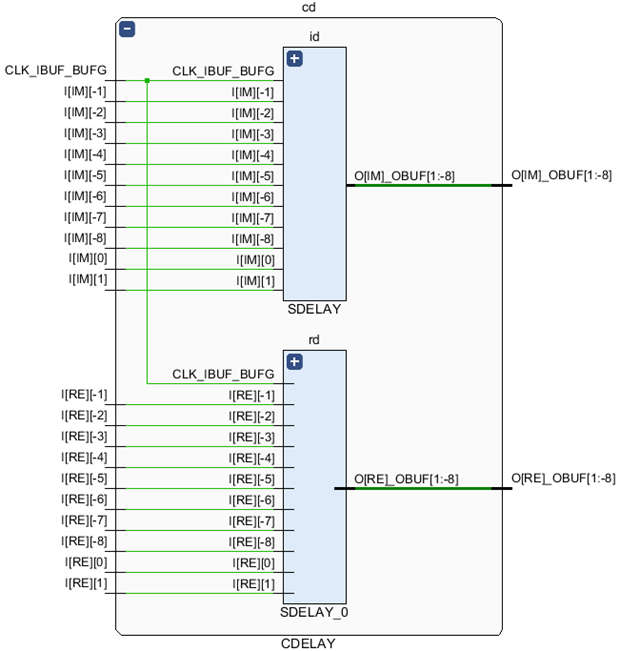

All the modules we have created so far will work in VHDL-93 with the exception of CDELAY which requires VHDL-2008 support because of the CFIXED type. In all cases, due to the strong typed nature of VHDL the signals connected to the I and O ports must have equal lengths and of course, the correct types.
These unconstrained port modules cannot be synthesized as such because the synthesis tool does not know what the actual ranges of the I and O ports are. These become known at synthesis time only when the generic module is instantiated with signals of known size attached to those ports. Here is an example of how such a CFIXED generic delay would be used in an actual design:

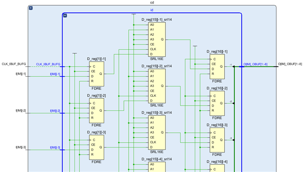

Here the CDELAY is 16 locations deep and the real and imaginary parts are 10-bit wide. And this is how the synthesis result would look like for the CFIXED block:
And for one of the SFIXED sub-blocks, showing only 3 of the 10 bits:
As mentioned earlier, while this design solution is very simple and elegant, the synthesis results might or might not be what we need. In this particular case we get an input FF, an output FF and 14 intermediate delays mapped into an SRL16, which is half of a LUT6. This implementation uses twice as many FFs as needed and a better choice would be an SRL16 configured as a 15 clock delay followed by a single FF (we will see later in another post why the final FF is required). The synthesis tool infers the extra input FF to make timing closure easier but this is rarely needed and does not justify the use of extra FFs. If you have just one such delay in a design, wasting a few FFs might not matter. If you have lots of them and your FPGA is already almost fully utilized this could become a critical issue.
There are many ways a delay line can be implemented in a Xilinx FPGA - as a chain of flip-flops, using primitives called SRL16 and SRL32, which can map up to 16 respectively 32 flip-flops into a half respectively a single LUT6, with distributed RAM and a counter where we can have the equivalent of up to 64 flip-flops in a single LUT6 or for even longer delays dedicated memory blocks like BRAMs (18Kb and 36Kb) and URAMs (288Kb) could be used. Which implementation is better depends on the delay depth and width as well as the available resources and this is design dependent.
A more useful xDELAY implementation would target different primitives based either on the SIZE value or another generic that could be used to force a particular implementation independent of SIZE. Such a generic could even be used to chose between the elegant behavioral implementation presented above and various implementations based on primitive instantiations. The same thing could also be achieved using an entity with multiple architecture definitions.
