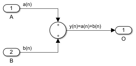

Let's consider the adder. First of all, the generic N-input adder, while nice from a mathematical point of view, is not something we would want to build in hardware because it is not scalable, its speed is inversely proportional to N if we implement it as a chain of 2-input adders or with log2(N) if implemented as a binary tree. We want the throughput, or speed, to be independent of N. So we will restrict ourselves to using only 2-input adders:

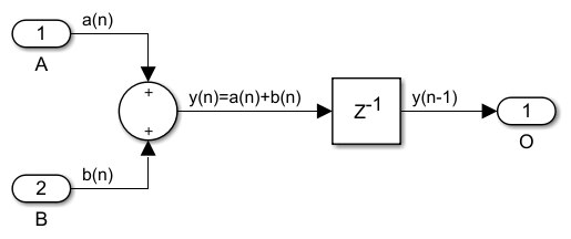

To the left is the mathematical adder, where you get the result y(n) as soon as the a(n) and b(n) inputs are available. To the right is the physical pipelined adder. It takes time, let's say 1.0 ns for y(n) to be computed when a(n) and b(n) become available and then you need to store this result somewhere before the next a(n+1) and b(n+1) input samples arrive on the next clock. The delay, which acts as a pipeline register here, serves this purpose. The point is that y(n) is not available right now to do other computations in parallel with the addition, only the previous y(n-1) result is. To achieve the highest possible speed and make that scalable or independent of the design size N, every adder will have to be followed immediately by a pipeline register. The original mathematical implementation of the FIR does not have these registers between the chained adders and this will have to be addressed.

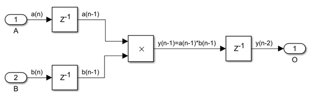

A similar situation exists for the second block, the multiplier:
Except that in this case we need two pipeline register levels to achieve the maximum possible speed. At any given moment in time, only the current a(n) and b(n) inputs and the product y(n-2) of two clock periods ago are available. The current product y(n) and the previous one y(n-1) are still in the process of being calculated and cannot be used for anything else.

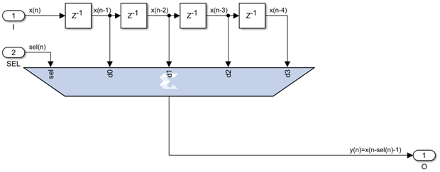

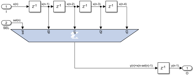

As a general rule of thumb, for a delay line N levels deep and m bits wide the LUT6 utilization is m*ceil((N-1)/16) and the FF number is m. It actually gets even better than this. We will soon encounter delay lines of a given length N but where we need to access any internal tap, not just the last one. As long as we access a single tap at a time, not necessarily the same one every clock, something described by the following diagram, we can achieve that for free without any extra resources being used:
On the left we have the mathematical equivalent of the tapped delay line and on the right the efficient hardware implementation. As long as we still use the final pipelining register level like on the right side of the diagram above, maximum speed can always be achieved no matter how large N is and the utilization numbers are exactly the same as for the fixed size delay line - the multiplexer is essentially free.

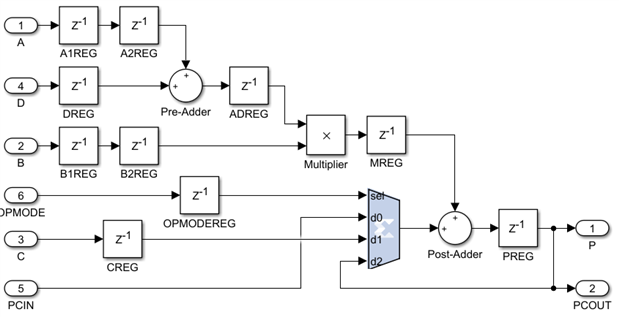

Finally, the adders, the multipliers and the delays are not completely independent of each other. The other major FPGA primitive is called generically the DSP48 and apart from a signed multiplier, it also contains a post-adder, a pre-adder and a lot of pipeline registers. There are also three distinct flavors called DSP48E1, DSP48E2 and DSP58 which are used respectively in the last three generations of Xilinx FPGAs, called 7-series, UltraScale/UltraScale+ and Versal. The way these sub-elements are used and connected is highly configurable, including dynamically at run-time. This is an oversimplified view of what is available inside every DSP48 primitive:
The pre-adder is 25-bit wide for DSP48E1 and 27-bit wide for DSP48E2 and DSP58. The multiplier is signed 25x18, 27x18 and 27x24 respectively, and the post adder is 48-bit wide for DSP48E1 and DSP48E2 and 58-bit for DSP58. Every single register can be bypassed and has an independent clock enable and synchronous reset, which gives us a lot of flexibility and implementation options. The pre-adder and post-adder are also very flexible and their operation can be modified dynamically. The point is that once we decide to use the DSP48 multiplier, we get all these other hardware resources for free so we want to create designs where as many adders and delays are also absorbed into the DSP48 primitive. However, this is only possible if we target the DSP48 architecture with our algorithm implementation.
