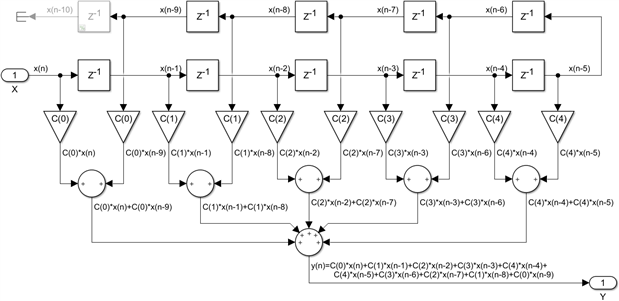

We have looked so far at the simplest and most generic FIR possible, the single rate non-symmetric FIR filter. But many FIR filter implementations have more particular structures and taking advantage of these can improve the filter efficiency in terms of resource utilization. The simplest possible variation is coefficient symmetry. As a matter of fact, more than half of the FIRs you will ever encounter will be symmetric in one form or another, and the general rule for symmetric FIRs is that you can always reduce the number of multiplications needed by a factor of 2x.
There are actually four variations of coefficient symmetry, symmetric and anti-symmetric, and both can have an even or odd number of coefficients. For now, we will consider only the case of symmetric, even-order FIRs, where the number of coefficients and the filter order is N=2*K. An example of such filter for K=4 and N=8 is shown below:
We will start making some changes to this filter, without affecting its functionality. We will fold the second half of the input delay line on top of the first half and take advantage of the associativity and commutativity properties of the addition to rearrange the post-adder. I have added one extra input delay at the very end, marked in grey, which makes no difference because x(n-10) is not used anywhere:
The next step is to swap the order of multiplications and additions in each transversal branch, a mathematician would call this the distributivity of multiplication over addition. The net effect of this operation is a reduction in the number of multiplications by a factor of 2x and this is typical for all symmetric FIRs:
Now it is the moment where we can address the other three symmetric FIR variations. If the filter is anti-symmetric, the five pre-adders would be replaced by five pre-subtractors, but the general structure would remain exactly the same. In both cases, if the FIR is odd, that is N=2*K-1, all we have to do is remove the last delay in the forward half of the input delay line and the last pre-adder and we get the odd symmetric filter. If the FIR is both odd and also anti-symmetric, then C(4) will be zero. In all cases, a filter of any size can be built by cascading the following basic building block if we replace the 5-input post-adder with a chain of five 2-input adders:
