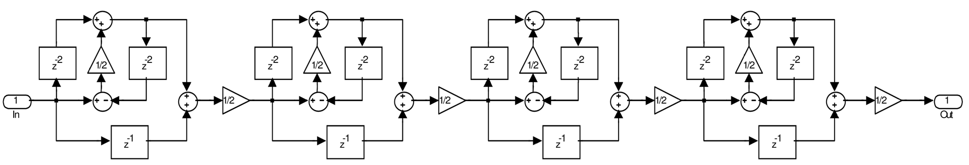

Its only redeeming quality is the fact that it is multiplier-less and can run at a sample rate equal to the clock frequency. Cascading four such sections however leads to the following 12th order-low pass filter:

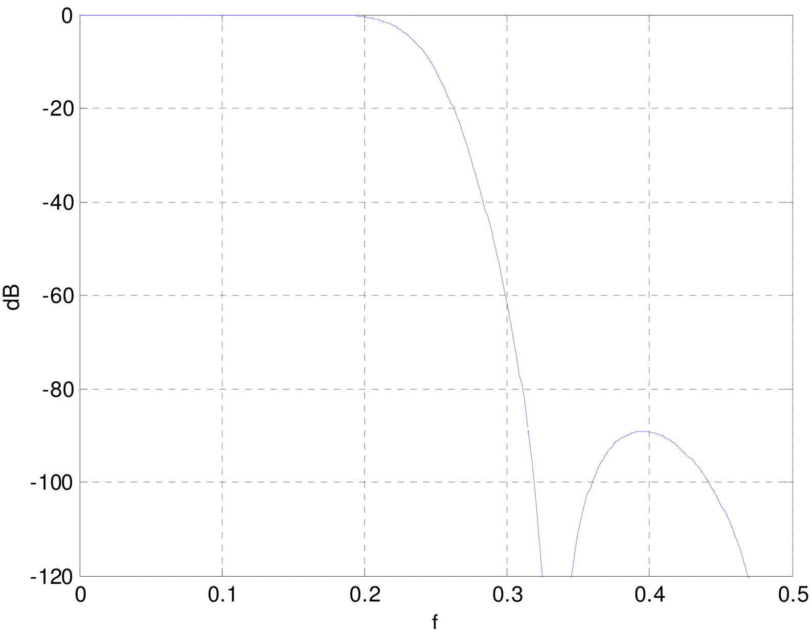

This has now a much more respectable transfer function, with 90dB stop band attenuation:

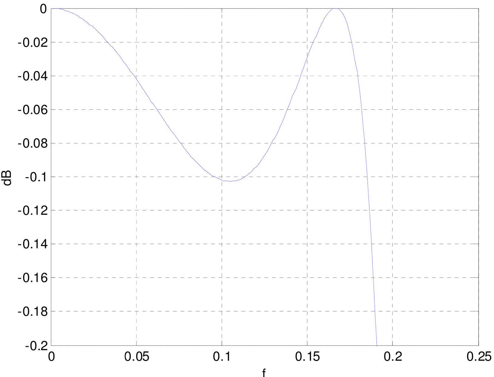

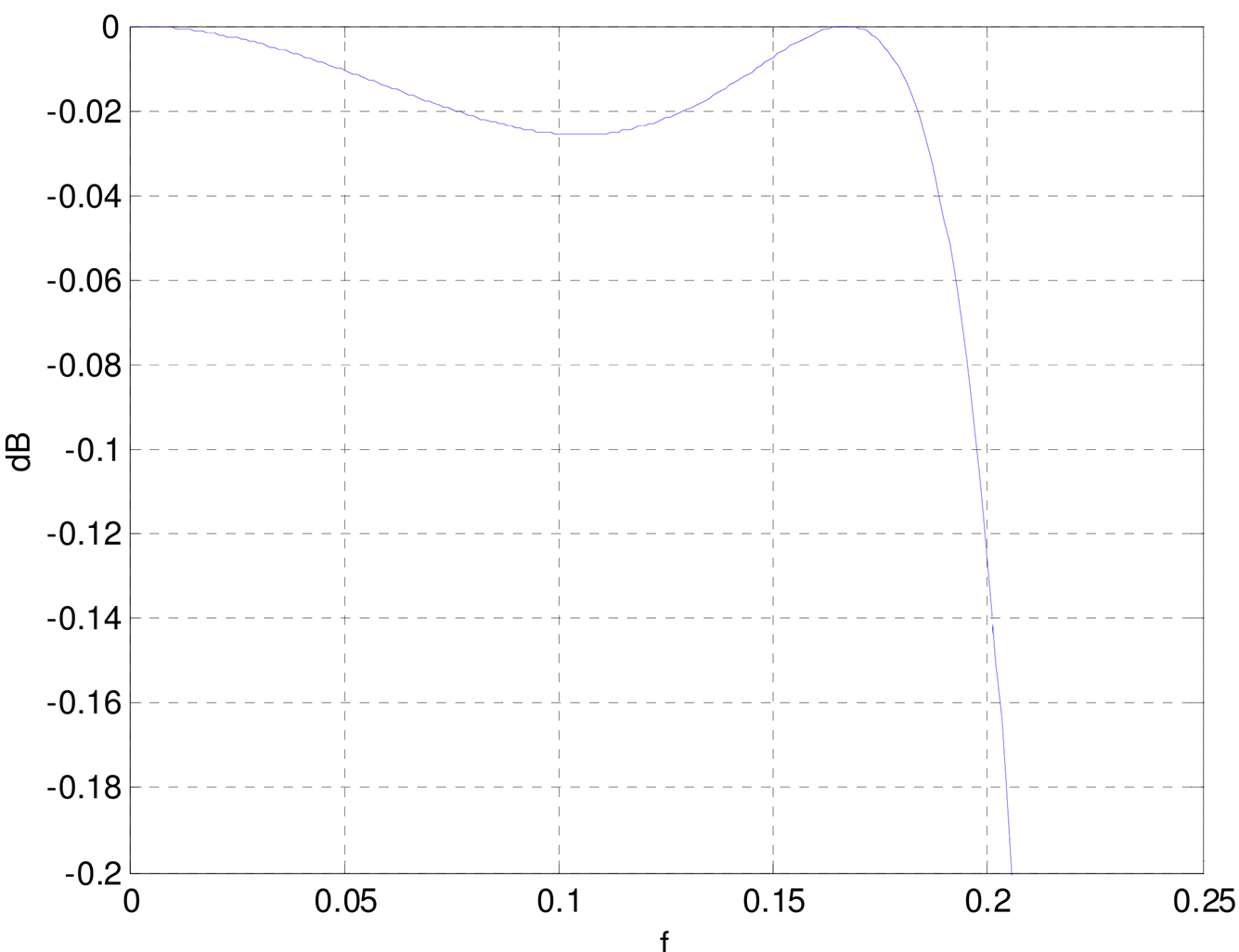

and 0.1dB pass band ripple:

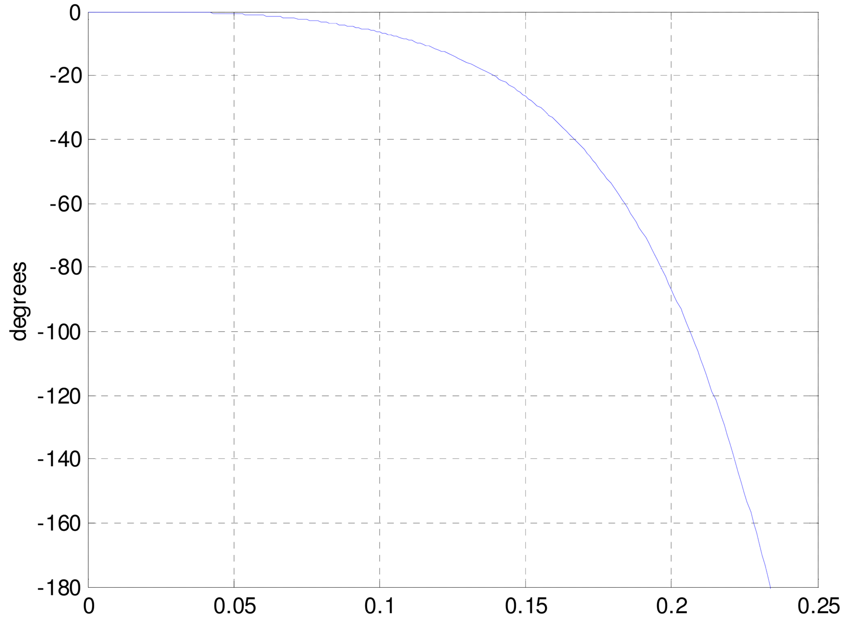

but an even more non-linear pass band phase. This plot shows the difference between the IIR filter's phase and the ideal linear phase, the error is up to 80 degrees over the entire pass band:

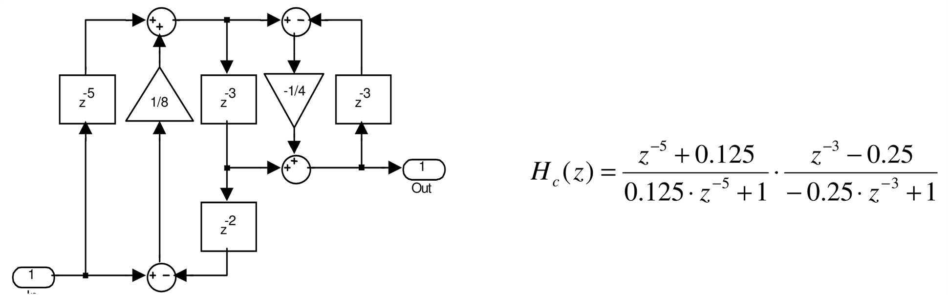

This is where things get interesting. The following all pass filter, consisting of a cascade of two first order sections with packing factors 5 respectively 3, and more importantly, coefficients that are still powers of 2:

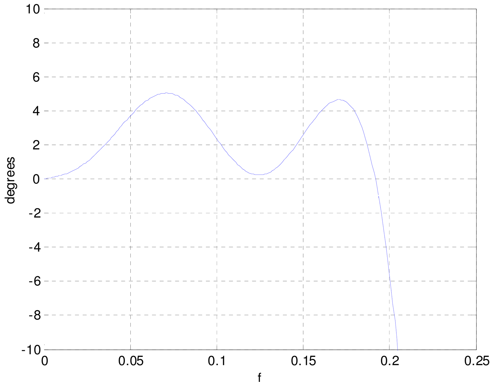

happens to have a phase transfer function that compensates most of the phase non-linearity of our original filter, without affecting the amplitude transfer function in any way. The phase non-linearity error in the pass band of the two cascaded filters is now just 5 degrees:
Is it perfectly linear? No, but for applications where this is good enough you cannot beat the performance. This will run as fast as you can clock your FPGA and will use only 10 adders in 7-Series or UltraScale families or 16 adders in Versal, and no multipliers.
