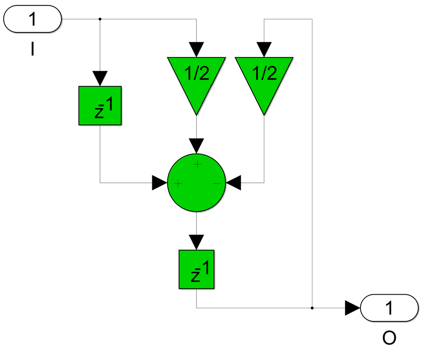

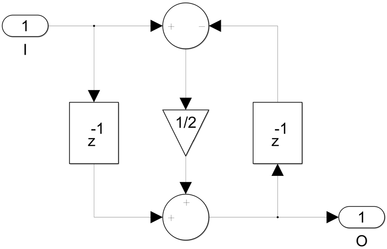

The simplest case we have already encountered is a single non-zero bit, or a power of 2. For example, if c=1/2:
we can replace the two adders and the multiplier with a single 3-input adder, without the need of introducing any extra registers:

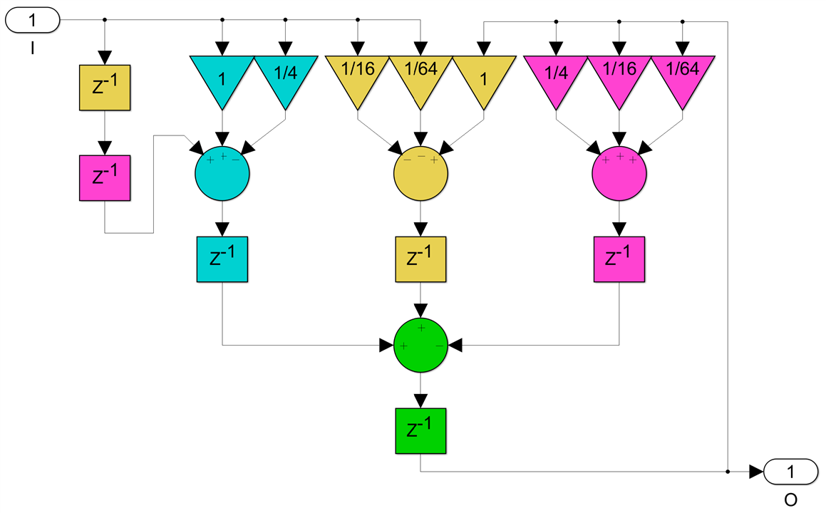

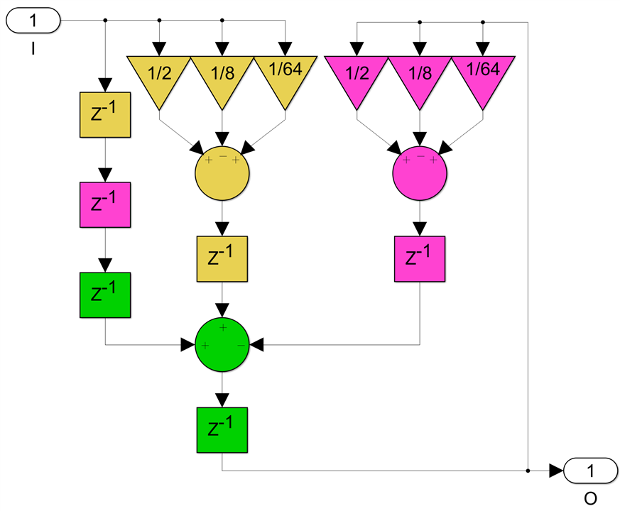

The 3 non-zero bits case, for example c=25/64:
can be done with three 3-input adders:

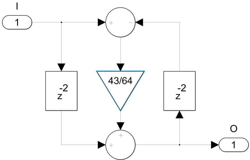

Finally, the 4 non-zero bit coefficients like c=43/64:
will require four 3-input adders:
