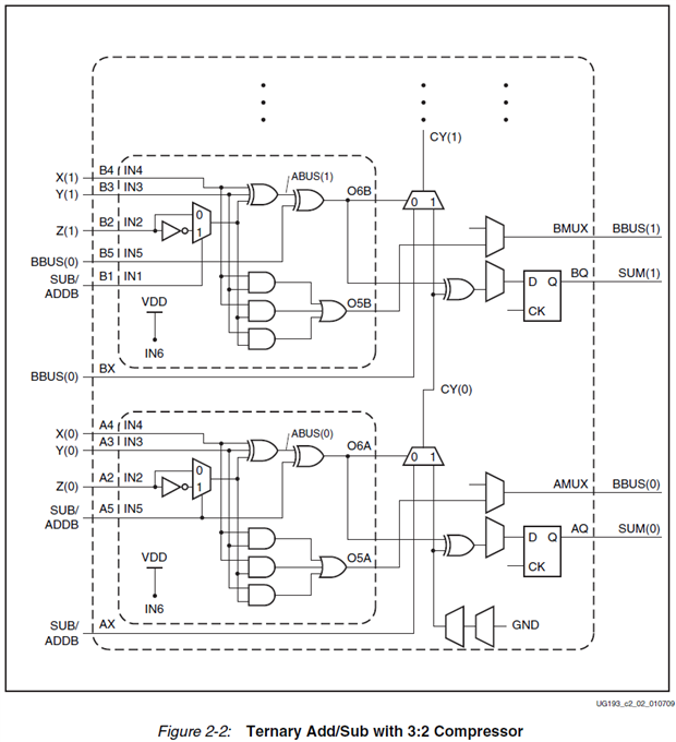

The Carry-Save Adder, two for the price of one
This post is about buying two adders but paying only for one of them.
When developing software the CPU and memory your code is running on is already paid for and there is little incentive to optimize your code to make it either smaller or faster. But as a hardware designer you literally pay for every LUT and FF in the FPGA you are using. If you could make your design smaller and faster you could do more with the same FPGA or you could use a smaller and cheaper one and if your volume production is significant this can translate into a lot of money. Fabric adders are one such good opportunity to increase the efficiency of a hardware design.
The Xilinx FPGA fabric has dedicated CARRY4/CARRY8 resources in every slice, which can be cascaded to build 2-input adders/subtracters of any size, using essentially one LUT6/FF pair per bit. If you need to add more than 2 terms you have to use more adders, in general an N-input add requires N-1 2-input adders, so N-1 LUT6/FF pairs per bit. There is however a better way to add many terms, which in general uses O(N/2) instead of O(N) LUTs per bit. Two for the price of one.

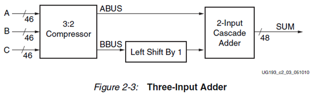

The key ingredient is a 3-input adder structure called a carry save adder. The basic idea is outlined in this diagram:
We compute first two intermediate values, a bitwise XOR of the 3 operands ABUS and a bitwise majority vote of the three operands BBUS. Then we do a normal 2-input ripple carry add of the first value and the second one shifted left by one bit and we get our 3-input addition result. If we want to avoid overflows the result has to be 2 bits larger than the operands. The trick is to observe that we can merge both the XOR3 and the 3-input majority voter logic functions in the same LUT6 that is used by the final ripple carry adder, like this:
Not only can we map all these logic functions in a single LUT6_2 but we still have one LUT input left, which could be used to implement more functions, like an add/sub dynamic selection or gating one of the three operands and so on. Unfortunately we cannot have two independent dynamic add/sub selects but we can do things like O<=±A±B or even O<=C±A±B with a static add/sub selection made with generic parameters.
So how can we get this efficient 3-input adder implementation? We can code it behaviorally like this:

The design now uses the expected 1 LUT6 per bit and can still reach speeds of over 800MHz. With this coding style we can indeed get two adders for the price of one.
In the next post we will see a few example designs where using this generic 3-input adder would make sense.
