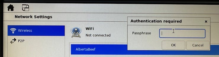

We will be using a DisplayPort monitor to view video output from the Ultra96-V2. You should observe the matchbox desktop on the DisplayPort monitor.
Ultra96-V2 - matchbox desktop (Camera: AlbertaBeef)
With a USB keyboard & mouse, click on "Connman Settings" to configure the WIFI.
Ultra96-V2 - Connman Settings => Network Settings (Camera: AlbertaBeef)
Click on "Wireless", then select your WIFI network, and specify your passphrase.
Once the WIFI is connected, you can discover which IP address has been assigned to your Ultra96-V2 with the following command:
