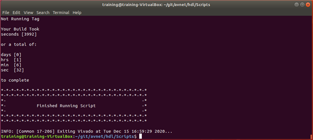

# Run the Vivado build script for the Ultra96-V2 dualcam design
$ cd Scripts
$ vivado -mode batch -source ./make_ultra96v2_dualcam.tcl
When the design is done building (keep in mind it takes a while, while in hours not minutes, note the time shown in the capture below) you will see this:

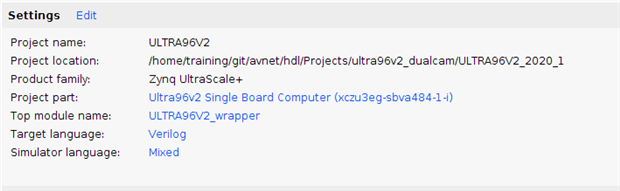

You can then open Vivado and navigate to the project, which should be here:

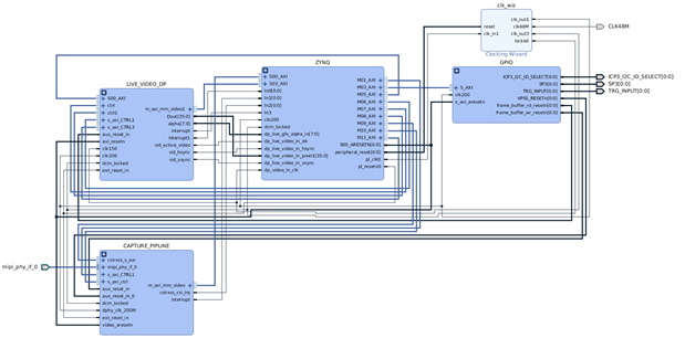

You can then navigate the project, connect to your target hardware and program if you'd like (be sure the boot mode is set to JTAG) or check out the block design. You're block design should look something like this:
You'll still need to build petalinux on top of this to have the full OOB image. When that design has been fully validated in our Github process I will post a followup blog outlining the complete build.
