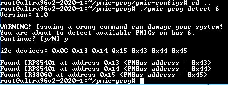

root@ultra96v2-2020-1:~/pmic-prog# ./pmic_prog detect 6
Version: 1.0
WARNING! Issuing a wrong command can damage your system!
You are about to detect available PMICs on bus 6.
Continue? [y/N] y
i2c devices: 0x0C 0x13 0x14 0x15 0x43 0x44 0x45
Found IRPS5401 at address 0x13 (PMBus address = 0x43)
Found IRPS5401 at address 0x14 (PMBus address = 0x44)
Found IR38060 at address 0x15 (PMBus address = 0x45)

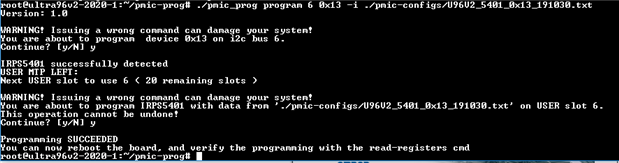

Device 0x13 programming
root@ultra96v2-2020-1:~/pmic-prog# ./pmic_prog program 6 0x13 -i ./pmic-configs/U96V2_5401_0x13_191030.txt
Version: 1.0
You are about to program  device 0x13 on i2c bus 6.
Continue? [y/N] y
IRPS5401 successfully detected
USER MTP LEFT:
Next USER slot to use 6 ( 20 remaining slots ) <- **Note the remaining slots section, if this is zero you can't reprogram! It should not be zero as reprogramming this part should only be done for this fix**
You are about to program IRPS5401 with data from './pmic-configs/U96V2_5401_0x13_191030.txt' on USER slot 6.
This operation cannot be undone!
Continue? [y/N] y
Programming SUCCEEDED
You can now reboot the board, and verify the programming with the read-registers cmd
