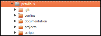

The Avnet git repository for PetaLinux projects contains the following subdirectories:
DirectoryDescription
configs
Contains the board-specific PetaLinux project configurations.
documentationContains the board-specific boot instructions for each of the supported boot methods.
projectsEmpty when the repository is cloned.  This is where the PetaLinux project will be created when the build script is run.  This folder is ignored by git.
scriptsContains the project build, boot, and rebuild scripts for each for each of the scripted build projects.
This structure has been setup for maximum flexibility in design creation as well as maximum reuse of designs . Avnet has made a commitment to using this structure to implement our designs in order to give our customers a consistent look and feel to our reference designs. This will allow anyone to be able to edit a project to fit their needs. Typically we will release a TAG (snapshot) of a project guaranteeing it’s validity for a specific configuration. This provides great flexibility for users to start with a known-good project and edit the scripts as needed to create a project that has been purpose built for the configuration they want.

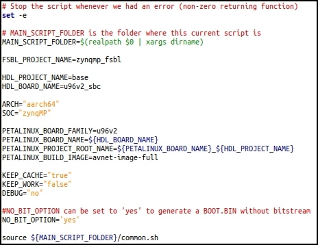

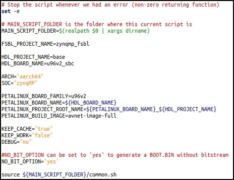

To get an understanding of what happens when we launch a scripted PetaLinux build, let's take a look at a sample build script and follow the chain of events that occur.  For this example we will examine the make_ultra96v2_sbc_base.sh build script.
Script Variables
This section is where build options like the project-specific and architecture-specific settings for the BSP are set.
Environment Setup
The build script will first check to see if the required git repositories have been cloned and that Xilinx environment variables have been properly set.  This part of the script will also check to see if the BSP is being built using a specific git tag. This is helpful when it is necessary to rebuild the complete BSP using the same git-controlled sources as the original BSP.

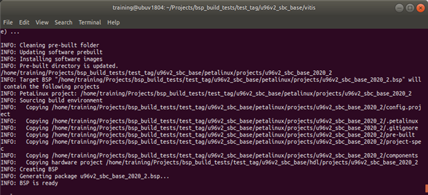

Launch the PetaLinux Build Script
Open a command terminal and navigate to the build scripts folder.
$ cd ~/git/avnet/petalinux/scripts
$ ./make_ultra96v2_sbc_base.sh
The build will begin and the terminal window will display the progress as the hardware platform is built in Vivado and the the Linux OS image is created.
