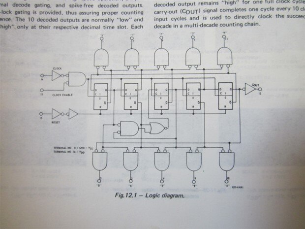

In this blog Add Pynq-Z2 board to Vivado Jan refers to a Johnson counter. I struggled to remember what a Johnson counter actually was, but, for some reason, the number 4017 came to mind. Sure enough, the CD4017 CMOS logic device turned out to be a decade counter/decoder implemented as a 5-bit Johnson counter with ten output decodes. The datasheet [1] even had an equivalent circuit for me to look at.
I also found a description of the counter in Designing with TTL Integrated Circuits [2], which says it's also known as a 'twisted-ring' counter or a 'Mobius counter': we'll see why in a moment.
I thought I'd have a go at implementing one, on my recently-acquired VIDOR 4000 board, driving some LEDs with the decoded outputs, as it's a bit more interesting than a straight 'blinky'. I'm not going to go into every small detail, but it will give an impression of how logic design is done with programmable logic, and one or two peculiarities of trying to work with the 4000 for the first time.

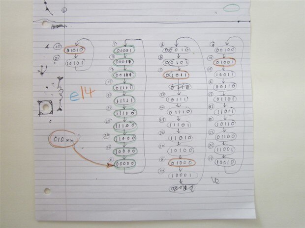

First I need to do a bit of design. With experience, it would be possible to launch straight in with coding, particularly if we use the higher level of abstraction for building a state machine that exists in VHDL and weren't too particular with how the software implemented what we'd asked for, but in this case I'm focussing on something low-level and I'm going to guide the synthesis to [hopefully] give me what I want without constraining it or forcing it in any way other than the form of the code, so I need to consider it a little.
It turned out, after I'd refreshed my ancient memories, that a Johnson counter is a simple form of shift register counter, where the output is fed back inverted to the input. It's the output being sent back inverted that leads to the names 'twisted ring' or 'Mobius'.
The inversion means that, if we start it off all '0's, it will cycle through 2n states before it returns to all '0's again. So a 5-bit Johnson counter, made from a shift register consisting of five flip-flops, will give us 10 states that we could decode. That immediately alerts us to a potential problem: with 5 flip-flops, we have 2^5 (32) possible output states, and since we're only going to be using 10 of those states, we have to give some consideration to the others. What happens if the circuit starts in one of the 'illegal' states? What happens if some chance event corrupts one of the bits? Will it self-correct? (ie do the illegal states find their way to the legal sequence, or do they sit in a closed loop?) To sort out those questions I'm going to draw a simple state diagram.
Not very tidy, but it does the job.
The states outlined in green are the legal ones. The orange is where I've noticed that each of the illegal cycles contains at least one term of the form 010xx, so if I detect that and reset the flip-flops, that will guarantee it always running back into the main sequence. [The 4017 uses a different scheme, where one of the flip-flop inputs gets manipulated if the sequence is wrong, but I didn't have the patience to sit down and work out how that functioned.]
Something that's a bit less obvious, when looking at the legal sequence, is that it's possible to decode it to give 10 different outputs using only a 2-input gate for each output. What's more, only one of the two inputs will be changing at any one clock edge, so the output decode should be glitch-free even outside the clocked process (similar sort of principle to a Grey code).

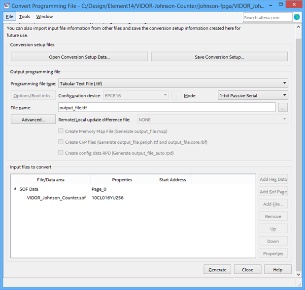

After running the 'compilation' (synthesis, fitting, assembly into a bitstream), you'd normally run the programmer task which would bring up a programming dialog, you'd select your hardware programmer, USB Blaster, or whatever, and then directly program your board.
For the Arduino route, though, we need to convert the .sof file that the programmer would normally work with into a text format (.ttf), and then use a utility program to get it into a form suitable for the Arduino bootloader. We include it in the Arduino project as a .h file (all the stuff I've seen refers to app.h, so I stuck with that as the file name). The linker will combine it with the program for the microcontroller on the VIDOR, but it doesn't form part of what's programmed onto that microcontroller because the addresses sit outside the address space of the part, instead the bootloader at the board end will recognise the addresses being out of range, realise that it's content for the FPGA, and instead push it through the FPGA to program the configuration memory attached to the FPGA. It's basically a trick to get it all into one payload for programming from the Arduino IDE, though it's very confusing when you first try to understand what's going on [as in, "how can a microcontroller, with only 256K of Flash memory, take and store an FPGA image that's larger than that?"] I still don't entirely understand what happens with the boot process, but it does seem to work. Once I had sorted out an approach that worked [by reading what others had done on the internet], I was more interested in trying out the FPGA than attempting to puzzle out Arduino's 'simple' approach to FPGA.
Converting to a text format is done within Quartus, using a utility on the Files menu.
The output .ttf file then needs further processing to give something suitable for the Arduino bootloader. Arduino provide a utility to do that. It has a .do extension and I had to look up what it was and how I might go about running it [Windows just asked me what I wanted to run it with]. Turns out it's a 'Java Servlet file'. Whilst pondering what to do with it, I searched around some more and discovered that people other than Arduino have done projects with the VIDOR and they skipped the hash stuff [I think the reason Arduino went with the Java thing is that it has an SHA256 library they could use] and simply did the bit-reversal part. I found one using Python and one using C, both very simple. I chose the C one here:
https://github.com/wd5gnr/VidorFPGA/blob/master/C/vidorcvt.c
and compiled it with VC++ 2010 Express, which was already on the laptop - it's a very simple command line program that could be compiled with practically any C compiler.
The signature stuff seems to be used by Arduino for their provided images, presumably so that code on the microcontroller can check that it's running with the correct image. There's also seems to be a scheme for seeing what functional blocks an image contains, but all that's unnecessary for a simple user project like I'm doing here.
