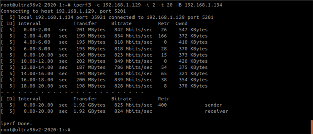

A USB Ethernet dongle is a cheap and easy way to get decent Ethernet throughput (600-800+ Mbps) using one of the USB 3.0 host ports on the Ultra96 and standard Ethernet LAN infrastructure.  This can be measured using the Linux iperf3 application (an accompanying iperf3 server needs to also be running on another node on the LAN):
$ iperf3 -c <server IP address> -i <interval> -t <total time> -B <wired Ethernet IP address>
Support for the Tripp-Lite USB 3.0 GbETripp-Lite USB 3.0 GbE adapter, which uses the Realtek 8152 chip, was added to the Ultra96-V2 PetaLinux 2020.1 BSP.  Previous BSPs had support for USB Ethernet adapters that use the Asix AX88179 chip (https://www.amazon.com/TRENDnet-Ethernet-Chromebook-Specific-TU3-ETG/dp/B00FFJ0RKE/).  This Prudent Way USB 2.0Prudent Way USB 2.0 adapter is also known to work with the Ultra96, but it is limited to 100Mbps.

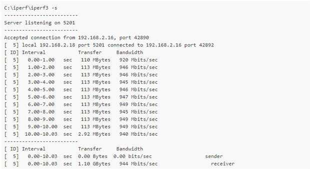

This mezzanine has 4 Ethernet ports each with their own SGMII interface using the high-speed mezzanine connector to the Zynq UltraScale+ device on the Ultra96 board.  Using Ethernet jumbo frames throughput of nearly 950 Mbps can be achieved:
https://www.fpgadeveloper.com/2019/07/measuring-the-maximum-throughput-of-gigabit-ethernet-on-the-ultra96.html/
