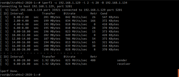

A USB Ethernet dongle is a cheap and easy way to get decent Ethernet throughput (600-800+ Mbps) using one of the USB 3.0 host ports on the Ultra96 and standard Ethernet LAN infrastructure.  This can be measured using the Linux iperf3 application (an accompanying iperf3 server needs to also be running on another node on the LAN):
$ iperf3 -c <server IP address> -i <interval> -t <total time> -B <wired Ethernet IP address>
Support for the Tripp-Lite USB 3.0 GbETripp-Lite USB 3.0 GbE adapter, which uses the Realtek 8152 chip, was added to the Ultra96-V2 PetaLinux 2020.1 BSP.  Previous BSPs had support for USB Ethernet adapters that use the Asix AX88179 chip (https://www.amazon.com/TRENDnet-Ethernet-Chromebook-Specific-TU3-ETG/dp/B00FFJ0RKE/).  This Prudent Way USB 2.0Prudent Way USB 2.0 adapter is also known to work with the Ultra96, but it is limited to 100Mbps.

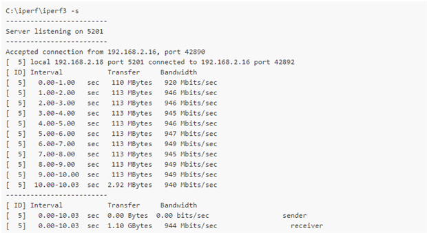

This mezzanine has 4 Ethernet ports each with their own SGMII interface using the high-speed mezzanine connector to the Zynq UltraScale+ device on the Ultra96 board.  Using Ethernet jumbo frames throughput of nearly 950 Mbps can be achieved:
https://www.fpgadeveloper.com/2019/07/measuring-the-maximum-throughput-of-gigabit-ethernet-on-the-ultra96.html/
Opsero also provides example designs for the Ultra96-V1 and V2 boards using both the Zynq UltraScale+ processing system gigabit Ethernet MACs (PS GEM) and gigabit Ethernet MACs in the programmable logic (PL TEMAC).

    I mention the Realtek vs Asix chips because they each have their own Linux device driver and are often found in USB Ethernet dongles from many brands (not just Tripp-Lite and TRENDnet) and only the Asix driver was historically enabled in the Ultra96 (V1 and V2) BSP.  Now that both drivers are enabled in the kernel configuration this will allow more USB Ethernet dongles from other brands to be used with the Ultra96 board as long as they use a chip compatible with the Realtek 8152 and Asix 88179 devices.  I haven't had any issues with either the Tripp-Lite (Realtek) or TRENDnet (Asix) adapters.
    As far as differences go, in some very simple Ethernet throughput testing I have done I have noticed the Tripp-Lite adapter appears to be quite a bit faster.  Here are a couple of iperf3 results from a server running on a Ubuntu host on my home office LAN and client running on the Ultra96.
    Tripp-Lite (844 Mbps):
    TRENDnet (587 Mbps):
    --Tom
