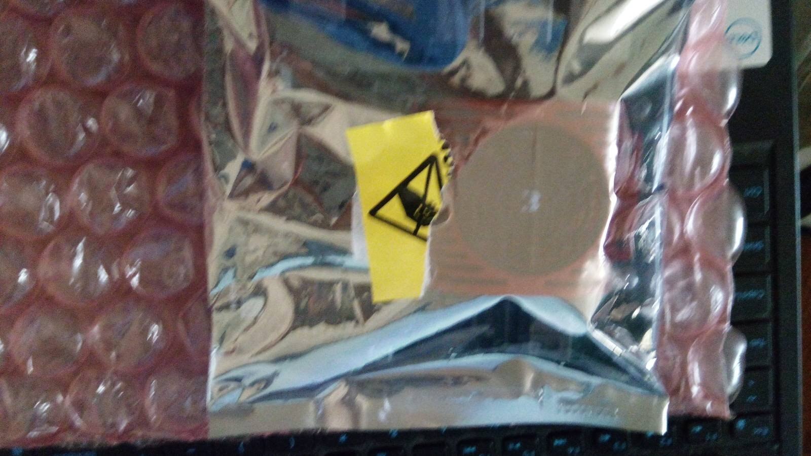

1. Unboxing the kit
Here are some unboxing photos. The SD card came pre-programmed. There is a 3D printed carrier card holder which is quite helpful.
{gallery} Unboxing photos
The kit includes the AI Vision carrier board with a non-production version K26LTD SOM,  a USB micro cable , HDMI and Ethernet cables, a power supply ,a USB3 BRIO camera and  a 3D printed holder.
The promotional material makes references to the AR1335 ONsemi MIPI camera however that was not included in the kit.

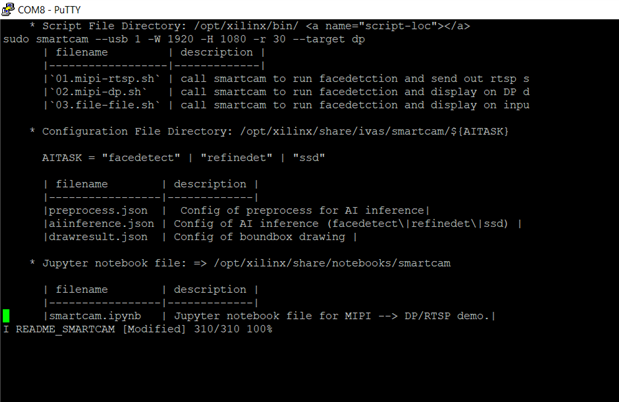

5. Smart Camera App
Petalinux image uses DNF as it's package manager so to install the smart camera app issue:
sudo dnf install packagegroup-kv260-smartcam.noarch
Initially I tried to run the kv260-dp app so in that case issue:
sudo xmutil unloadapp
This command has to be called everytime an app is stopped or another app has to be initialized.
This app works with the MIPI camera module from ON Semi and also with the USB camera. Only the USB camera was included with the kit .
sudo xmutil loadapp kv260-smartcam
Since the Brio USB camera was used the following needs to be issued to output data to the screen. Notice that the pipeline only supports 4K and 1080p resolutions.
Any lower resolutions are not supported so if your monitor does not support this you can try connecting to a TV or a monitor that supports at least 1080p.
sudo smartcam --usb 0 -W 1920 -H 1080 -r 30 --target dp
Different AI networks can be passed as arguments to the smartcam app. The videos were transcoded to h264 on the KV260 using ffmpeg.
/opt/xilinx/bin/smartcam --file /media/sd-mmcblk0p1/videos/traffic_with_rain.nv12.3840x2160.h264 --target dp --width 3840 --height 2160 -r 30 --aitask ssd
/opt/xilinx/bin/smartcam --file /media/sd-mmcblk0p1/videos/walking_humans.nv12.3840x2160.h264 --target dp --width 3840 --height 2160 -r 30 --aitask facedetect
/opt/xilinx/bin/smartcam --file /media/sd-mmcblk0p1/videos/walking_humans.nv12.3840x2160.h264 --target dp --width 3840 --height 2160 -r 30 --aitask refinedet
It's important to note that the apps only target 1080p and 4K resolutions. Testing the MIPI or USB pipeline with lower resolutions on the smartcamera pipeline gives a message saying it's not supported.  Hence for most of the tests I had to use a 4K TV monitor.
One thing to notice is that the AI detection is not 100% accurate:
