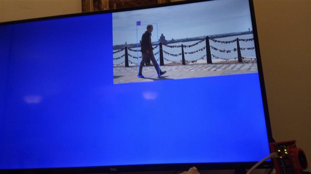

6. AI Box with ReID Accelerated Application
This app uses either an RTSP or offline videos. The offline videos need to be converted using ffmpeg
sudo dnf install packagegroup-kv260-aibox-reid.noarch
To test the app any previous app should be unloaded.
sudo xmutil unloadapp
sudo xmutil loadapp kv260-aibox-reid
jupyter-lab --ip=ip-address &
For the IP address use the Ethernet IP found by issuing:
ifconfig
The startup guide is found under:
https://xilinx.github.io/kria-apps-docs/master/docs/aibox-reid/aibox_landing.html
Transcribing videos
Install the gstreamer package:
sudo dnf install gstreamer1.0-plugins-good-jpeg.aarch64
and the ffmpeg package also.
{gallery} My Gallery Title
REPLACE THIS TEXT WITH YOUR IMAGEimage
It's interesting to notice that the accuracy of the SSD is not that great as it keep identifying a car where there is none. Depending on the flags different AI networks can be passed to the vision pipeline.
The AI BOX ReID app makes use of the video mixer IP.
It can show up to 4 simultaneous video streams. The mixer IP video stream locations are given as a parameter. Here you can see video mixer positions 1 and 2.
The -p flag at the end is the video location on the mixer palette. Location are specified as 0-3.
sudo aibox-reid -s /home/petalinux/Liverpool.nv12.1920x1080.h264 -t file -p 2 -s /home/petalinux/Freeway.nv12.1920x1080.h264 -t file -p 1
