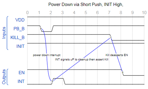

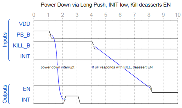

The Xilinx Zynq UltraScale+ MPSoC device has an integrated Platform Management Unit or PMU. This PMU's functionality is described in Chapter 6 of Xilinx UG1085, Zynq UltraScale+ Device Technical Reference Manual. The PMU controls many things on the ZU+ device, including powering up and down the ZU+. The Ultra96-V2 incorporates an On/Off controller to interface between the on-board power regulators and the ZU+. This allows the ZU+, Power Button, and regulators to seamlessly work together to power the system on and off without corrupting your Linux (or other OS) file system.
The key inputs/outputs of the system are detailed below:
Signal NameSourceDestinationPolarityDescription

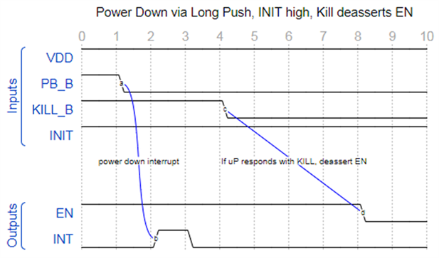

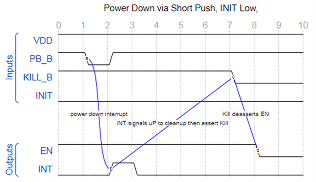

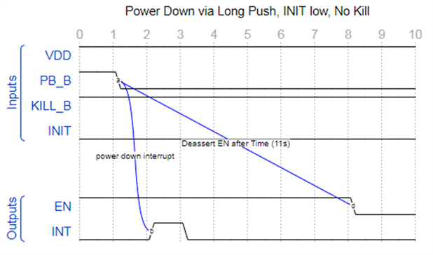

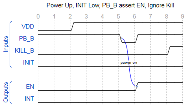

PWR_PB_NPush Button (SW4)On/Off Controller (U6)Low-enabledPush button input for powering on and off. Responds to both short and long pushes. When the system is powered off, a short or long push initiates a power-on sequence. When the system is powered on, a short push will trigger an interrupt, telling the Xilinx PMU to perform a shutdown. A long push (~10 seconds held down) will also issue an interrupt but will power off the system regardless of whether the PMU issues KILL_N or not.
MIO34_POWER_KILL_NZU+ (U1)On/Off Controller (U6)Low-enabledDisable the power regulators immediately. The ZU+ PMU enables this when it has properly processed an internal shutdown command successfully and is ready for the on/off controller to turn off the regulators.

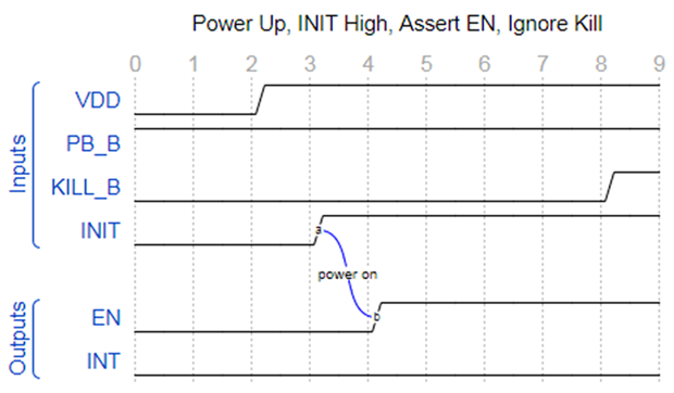

EN_SEQ_PLOn/Off Controller (U6)Pmics (U11, U12, U21)High-enabledEnables the three primary Infineon power regulation devices. Asserted by the On/Off Controller during a power-up sequence, and de-asserted by the On/Off Controller during a power-down sequence (either a response to KILL_N or a long push).
MIO26_PWR_INTOn/Off Controller (U6)ZU+ (U1)High-enabledInterrupt input to the ZU+ when a power-down push button event has been received.

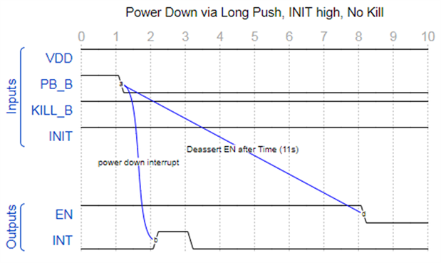

INITStrapping resistor (JT6)On/Off Controller (U6)Default = LowWhen low, the On/Off Controller powers up with the push button control. When high, the On/Off Controller powers up the system as soon as the input voltage is valid.

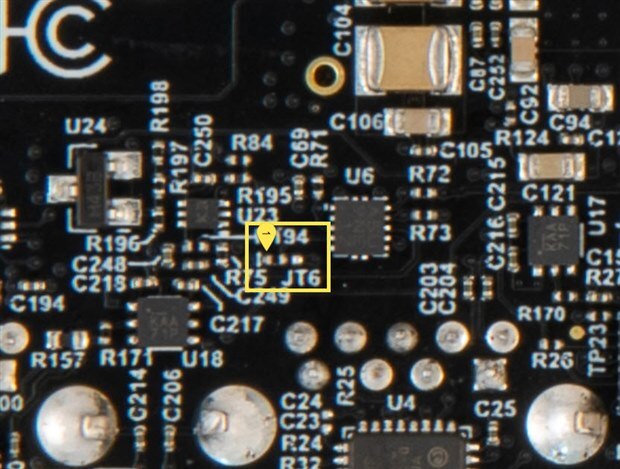

For those that want to modify the power-up initialization from push-button control to power-up with power connected, you will need to move a single resistor on the Ultra96-V2. This is the 3-pad, 10-Kohm resistor JT6, which selects either pull-down (default, use Push Button) or pull-up (power up with power). To implement the Power Up with Power Connected function, move the JT6 from position 1-2 to position 2-3. JT6 is located on the backside of the Ultra96-V2, so you will first need to remove the heatsink. JT6 is then located in the upper right of the southwest quadrant, near U6 as highlighted in the photo below.
To help explain the functionality of this device, a datasheet is available at Dialog SLG4G42480 On-Off Controller Datasheet . Also, here are several functional diagrams showing the logic within this device.
