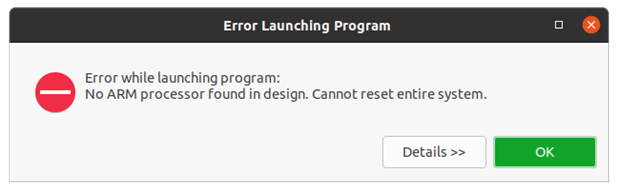

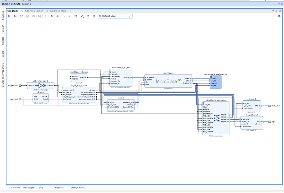

I've created a simple design in Vivado 2020.2 that consists of a Microblaze, UART, SPI and LEDs. I enabled interrupts but haven't yet utilised the triggers.: all went well and bitstream was generated, which I then exported along with the hardware.
Once exported I switched across to Vitis IDE and created an Application Project, importing my XSA hardware and selecting the 'Hello World' project. Programming the hardware also seemed to work correctly. However when I run the 'Hello World' example I get an error and I'm unsure what it relates to or how to fix it.
My target board is a Digilent Arty Z7 although my design is not utilising the Zynq.

    The initial error message suggests that your hardware contains a MicroBlaze processor but that Vitis has been configured to compile code for the Zynq hard processor. It's difficult to diagnose any further…

    The initial error message suggests that your hardware contains a MicroBlaze processor but that Vitis has been configured to compile code for the Zynq hard processor. It's difficult to diagnose any further without seeing your software setup. If it helps, I created a video walk-through of creating a MicroBlaze core in Vivado 2020.1 as part of this road test: Cmod S7: Breadboardable Spartan-7 FPGA Module - Review Obviously it's for the Cmod S7 rather than the Arty Z7 although the process should be exactly the same.
    The strange behaviour once you added a Zynq wrapper is something else though. I'd have expected your code to run on one of the processors at least!

    Did you have the "No ARM processor found in design" message ? I never did get to understand why the message appeared although the other members' comments proved very useful in my wider understanding of Vivado and Zynq. Since this post I did find that the UART (as used for the messages) was hardwired to the Zynq programmable system and therefore it would be difficult to do a 'Hello World' application in C without actually using the UART and hence the Zynq...maybe in some convoluted way that is why my error was appearing?

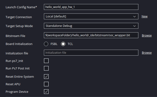

    I stumbled upon a similar issue with Microblaze-V when I tried to run a SW app with default settings. The latter include initializing and post-initializing the PS7 (processing system on Zynq targets) by default. You have to untick those when you have no PS7 system in your design.
    See the ps7_init and ps7 post init in the screenshot below.
    I hope this helps.

     brhn I see, Vivado gave a warning saying that a PS7 cell might be needed for my design, indeed.
    So I added a ZYNQ7 and connected its FCLK_RESET0_N to the reset pins of both the clock wizard and the processor system reset (instead of a constant 1 I was using before). But now, I no longer see the RISC-V Hart among the targets... Slight frown
