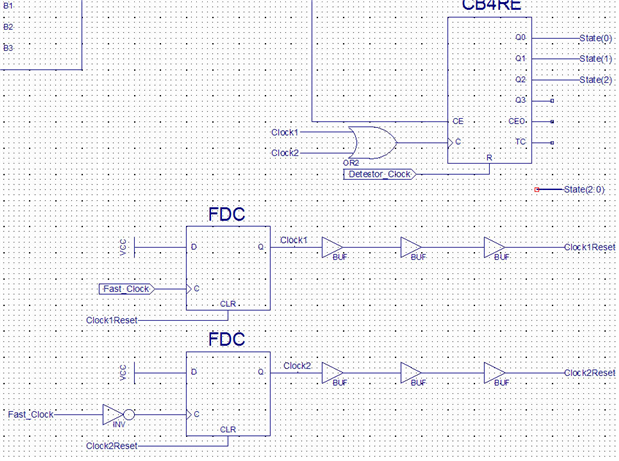

    0 genebren over 5 years ago
    Jan,
    I remember that some Xilinx parts (XC9500 and CoolRunner CPLD) use to have DUALEdge or Cool_Clock logic built in.  They used special attributes to enable this feature into the synthesis process.
    Here is a couple of wild approach to synthesize the same sort of thing with a little creativity and hand-waving (all credit to the previous posters):
    and
    Grant, years ago I published a reliable clock doubler circuit, part of the "six easy pieces" that seem to be lost.
    In words: Run your 10 MHz clock through a 2-input XOR. Generate a toggling flip-flop by feeding Q back through an
    inverting LUT to the D input. Route the signal driving D also to the second XOR input. Use the XOR output to clock
    the flip-flop, and also use it as your 20 MHz clock.  Disadvantage: If your 10 MHz doesn't have 50/50 duty cycle,
    your 20 MHz will have frequency modulation. And the High (or Low depending on XOR or XNOR) time of your 20 MHz clock
    will be short but you can lengthen it by adding delay to the Q- to-D path. Anyhow, it's self-adaptive to the device
    speed. Use this trick only when no PLL or DLL is available. Peter Alfke
    Both of these approaches should work and pass through synthesis as they both use combinatorial logic to blend the clocks.
    Best of luck!
