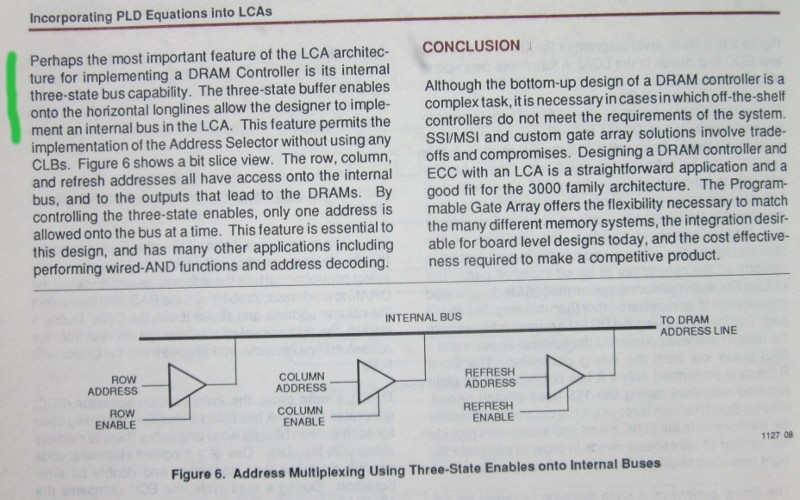

    I think that some of the difficulty here might be because it's valid to describe, in VHDL, a tristate internal bus between entities. Doesn't matter whether it can be done any particular hardware or not, the synthesis just has to get on with it and, if necessary, translate it into an equivalent logic form (usually it would constitute a multiplexer in some arrangement). At the top level things are unambiguous - the 'tristateness' must be referring to an IO pin. But a tristate at the top of the blocks, one level (or more) down, might just be forming a bus with other entities in the design and not go anywhere near an IO pin. Alternatively, as another example, there could be an internal tristate bus that simply feeds an output pin. So something extra that clears up the ambiguity is necessary.
    If anyone is interested, there's an historical twist to this because Xilinx FPGAs, once upon a time, did actually include internal tristate busses and they could be designed with quite explicitly.
    Here's how 'long lines' are shown in the 1989 Xilinx databook. Notice the tristate drivers.
    Here's part of an application note showing how the 'long line' could be used for fast multiplexing of the various addresses to implement a DRAM controller.
    I did a design around that time which controlled VRAM and can just about remember using tristate buffers and an internal bus in that way for multiplexing the RAS, CAS, etc (it was done with schematic capture and the part library had a '125' part, ie equivalent functionally to a 74125 tristate buffer, that you could use). Can't remember if I was using 2000 or 3000 series parts.
    I imagine it was a bit of a liability for them at the time because of the way you might disrupt the device operation if you got the control of the buffers wrong.
