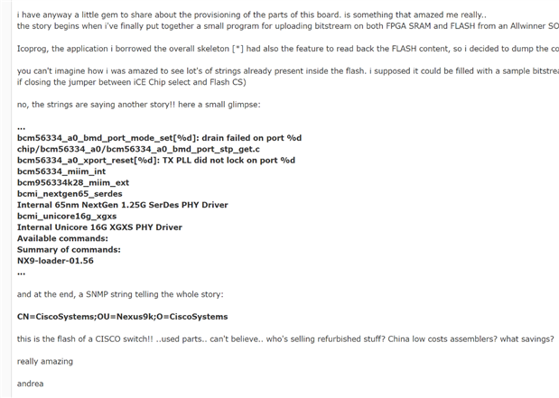

    I just looked at the other thread you linked to and then saw the schematic linked by shabaz for the board. OMG... I'd have not bothered even looking at the PCB based on the schematic design alone. It looks…
    shabaz over 8 years ago in reply to rachaelp +7
    I think it is a bit mean he is blaming a 'high school kid from Sri Lanka'. The product is from his firm with his name on his website, he should take responsibility. The buck stops with him. He should have…
    shabaz over 8 years ago in reply to johnbeetem +5
    Hi John! I think it is possible the price-point is low because it could be reusing old components, maybe.. There was some comment on the other thread that the serial flash had strings in it from some other…

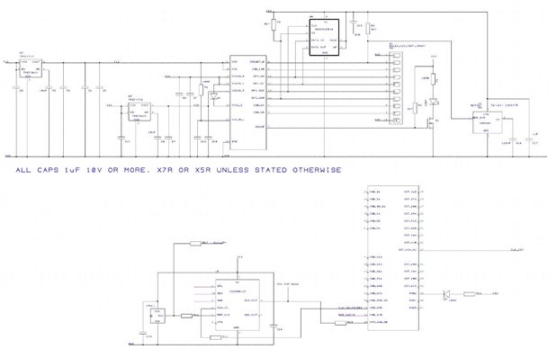

    In the hope that it might be useful here are some design notes I did for a customer who did their own pcb design (lots of other audio stuff on it that we won't talk about).
    The fancy clock chip is not needed for general work (and costs more than the FPGA). Where a symbol has  part name inside and a different one outside then the outside one prevails.
    This design uses some 1.8V IO and some 3.3V.
    If you want chips I would get an order in because some one may gobble them up - I've ordered 25.
    I'm glad you shared that schematic as no matter how hard I search I can't find the full pinout on the Lattice website! They refer to a pinout file in the datasheet but give no link to it and it's nowhere to be seen!
    Best Regards,
    Rachael
  • michaelkellett
    michaelkellett over 8 years ago in reply to rachaelp
    You need to know the secrets of Lattice's web site and organisation image
    iCE40 Ultra / UltraLite / UltraPlus - Lattice Semiconductor
    Near the bottom of the page, download the ICE40UP5k pinout - it's a .xlsx file.
    http://www.latticesemi.com/view_document?document_id=50697
    BTW - my schematic is the iCE5LP4k which may be slightly different.

    michaelkellett over 8 years ago in reply to michaelkellett
    There is one difference in pins between the Lattice speadsheet for the up5k and my schematic and Lattice's spreadsheet for the LP4k
    It won't break any thing much but RGB0 and RGB2 are swapped on my schematic re the up5k.

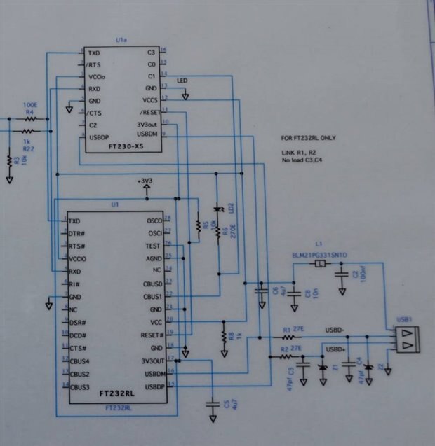

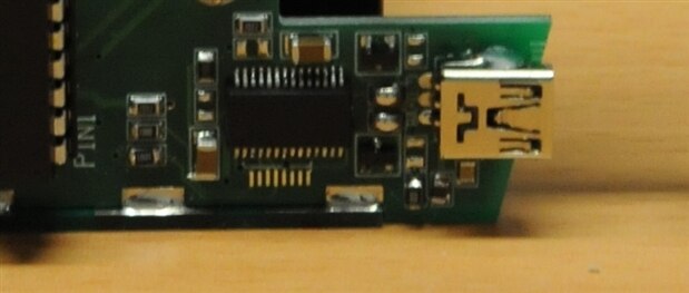

    mcb1 over 8 years ago in reply to rachaelp
    For the Xmas Tree we provide to schools, the PCB was arranged to allow either FTDI chip to be populated.
    (Sorry about the image quality)
    If you added Header pins, you could easily use an off board programmer which a number of other boards use.
