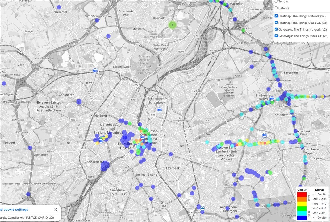

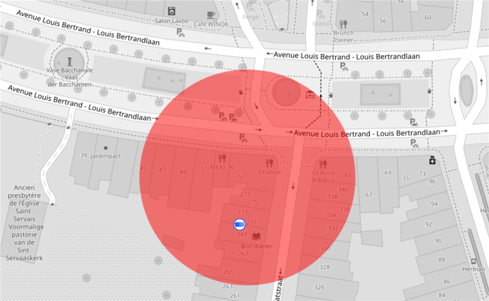

    My own personal heatmap bubble:
    The blue circle is my gateway. The red one is the LoRaWan activity of the Thing.

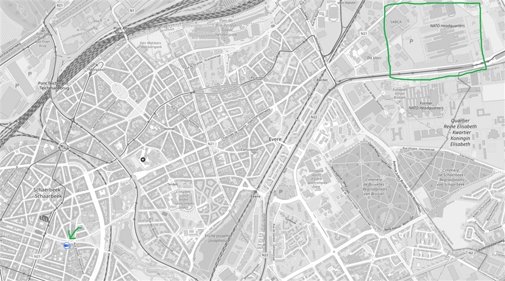

    shabaz over 2 years ago in reply to Jan Cumps
    Actually a really nice location in the city!
    Are the other heat map areas locations of commercial or industrial activity? Probably a lot of businesses own their own gateways.
    Jan Cumps over 2 years ago in reply to shabaz
    It's usually schools, tech startup locations, ...
    Based on what I can see from where I put the antenna, I expect that this is the angle that it can cover.
    I'm looking down onto that arena. A few valleys between my location and the horizon may be obstructed. But in essence, clear view as far as the eye reaches.
