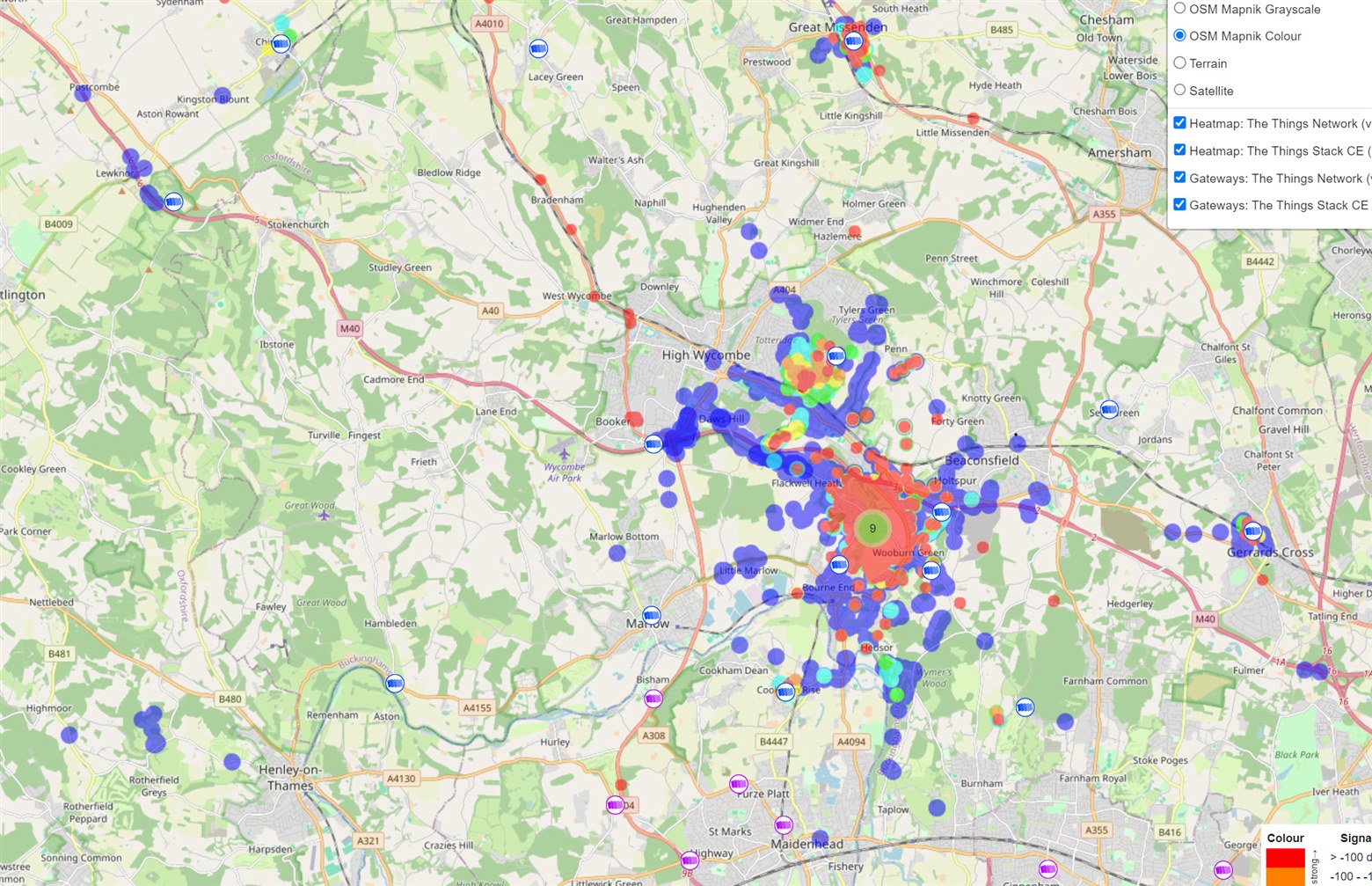

    My own personal heatmap bubble:
    The blue circle is my gateway. The red one is the LoRaWan activity of the Thing.
    Jan Cumps over 2 years ago
    shabaz over 2 years ago in reply to Jan Cumps
    Actually a really nice location in the city!
    Are the other heat map areas locations of commercial or industrial activity? Probably a lot of businesses own their own gateways.
    I got curious and had a look at some areas in the UK. The big splodge of colour area here is some sleepy small town, I've no idea what is going on there, but they seem to use LoRaWAN quite a bit!
    That splodge of colour at the top is where Roald Dahl used to live. Another village pretty much, perhaps people are using it to monitor their vast real estate: )
  • beacon_dave
    beacon_dave over 2 years ago in reply to shabaz
    Hotspot looks centred on a golf club and a farm. A lot of livestock are remotely monitored these days and they wander about a bit while grazing.
    Jan Cumps over 2 years ago in reply to shabaz
    It's usually schools, tech startup locations, ...
    Based on what I can see from where I put the antenna, I expect that this is the angle that it can cover.
    I'm looking down onto that arena. A few valleys between my location and the horizon may be obstructed. But in essence, clear view as far as the eye reaches.
