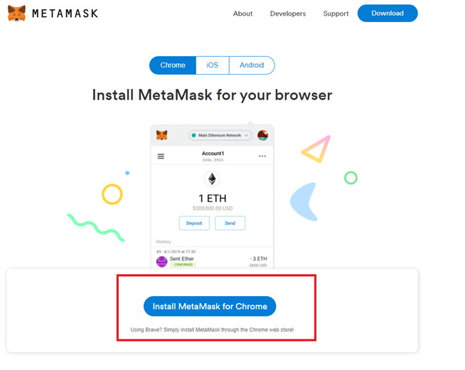

Install MetaMask and Create a Wallet
Then, (I did it on a laptop): Add metamask plugin to my browser.

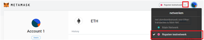

Then, when the plugin is opened:
  • create account
  • create wallet
  • Switch to Ropsten test network

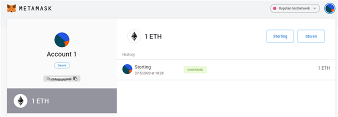

Get a 1 ether Test Coin in your Wallet

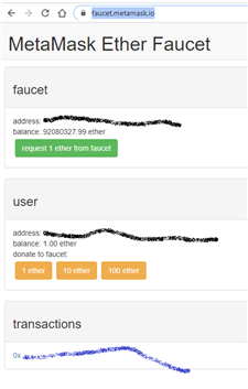

Then open a new tab to https://faucet.metamask.io/

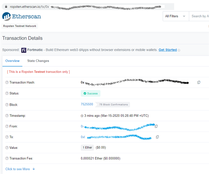

When you click on request one ether from faucet, it asks to log on to your metamask wallet and then creates a transaction id for 1 ether.
When you (right-)click on the transaction URL, you navigate to the ropsten test website and see the status.
When that page confirms success of the transaction, the 1 ether is in your wallet.

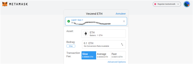

Transfer 0.1 ether to the Infineon Card

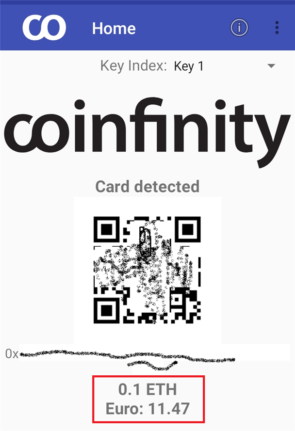

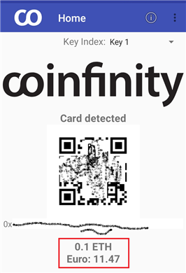

You can now transfer this to a card. I entered the address of my card by tapping it on the phone with the coinfinity app open,
then used the QR button on MetaMask and my PC camera to scan the QR. This worked well.
After some time (I chose the Slow option to prevent burning my test money), the amount was transferred.
Test if the Money Arrived
When I now tap that same card to my telephone with the coinfinity app open, it shows the amount, if you selected Key 1.
This budget can be used now in transactions with others ....

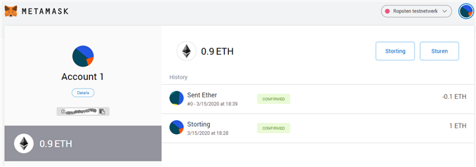

    My balance after the transaction:
    oldest transaction was the 1 free (yet worthless) ether.
    Then I moved 0.1 of that to the smart card*, and that costed 0.000042 ether.
    I now have 0.1 on that card and 0.899958 ether left in the MetaMask wallet.
    * the coins aren't on the card. Not even stored on there. The coinfinity app uses the cards keys to go and retrieve the ballance of the account related to that key.
