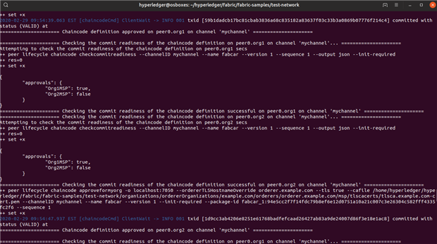

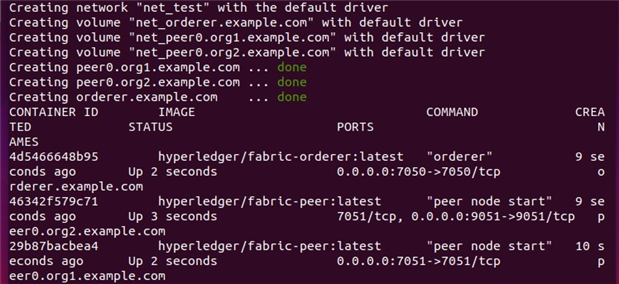

Here's the startup of the services:

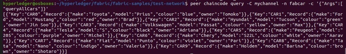

Query by org1, on ledger instance running on port 7051:

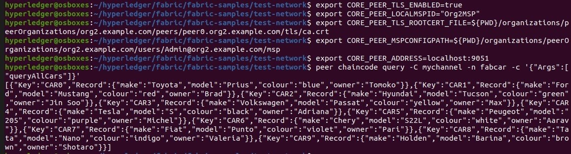

The same query, performed by org2, on a different but chained ledger, running on 9051:
