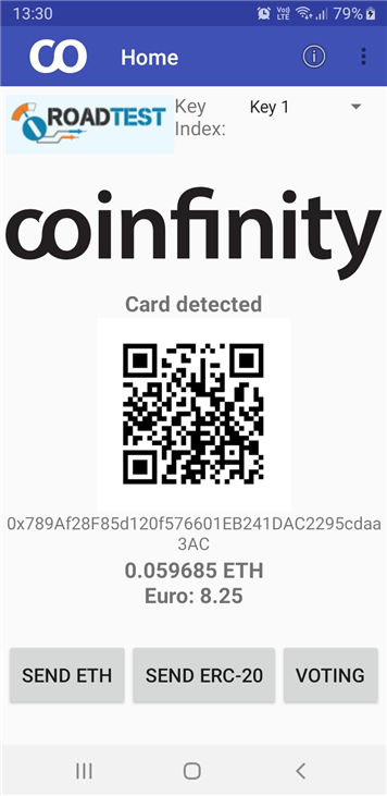

Sender
The app does exactly what's listed above.
The Who's The Sender part is discussed before. That's done by tapping a card to your phone.
Then (assuming you have dough on your Infineon card) , you select the SEND ETH button.
Here you can set the receiver of your money.

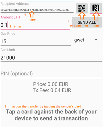

Receiver
If it's a transaction between to people in a single place (maybe the sender gives raw material to the receiver), the receiver can tap his card to that same telephone.
That sets him as the receiver.
For transactions that aren't physical, you can use the raw Ethereum address of the receiver, or a QR code.
In a warehouse, you would have a wall full of laminated (non-reflective!) QR codes of receivers, that cab be scanned by the phone's cam.
Scanning the right code then sets the receiver.
You can also type the 20 byte (40 hex character) address. But who wants to do that?
Once both parties are known, the amount to be transferred can be set.
In the Coinfinity app, you do this by typing an amount. In a logisitcs application, this could be done by scanning the goods-to-be-delivered ...

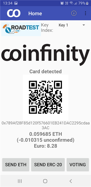

Firming by the Sender
Then the real stuff: approving the transfer.
As in the real world, it's the owner of the money that makes the transaction real. In our scenario, that's the sender.
There is no way around: the sender has to do that by presenting the card to the telephone.
Then APIs are used to ask the card to hash the data with the private key stored on that card. (important: the hash of the currently last transaction has to be part of that data. It's part of the resulting hash. This is actually the core of the blockchain principle).
The only secret here is that key. The transaction data is known. The resulting hash can be seen by all involved.
The magic sauce happens on the card. Turning that data into a non-reversable hash.
There's no known way (hi, NSA) to turn the hash into understandable data. But there's a way to validate that the hash is made by the owner of a public key that's shared.
Then that transaction, including the hash is sent to the blockchain. If it's from a known address, it's sent for validation to the peer chains.
A validated transaction will then be synchronised over all chains.

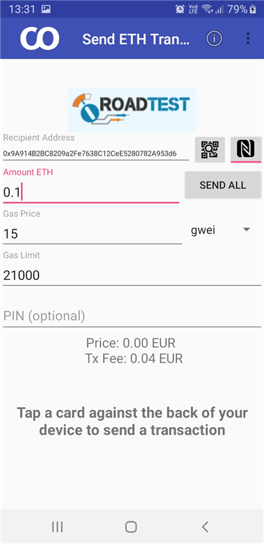

We start where we left  in the previous post, at the point where the sender's card is detected and the address known.
The receiver address is read in the same way (if you chose to do that by tapping your buddy's card to retrieve it).
Then you fill in the amount and tap the phone. Here is where we continue the story ...
*** I used 0.01 in the debug session below
Here we go. All info from the App screen is collected, then handed over to this function:

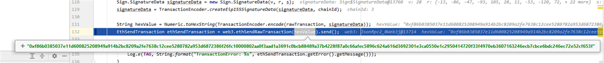

This one is called. It's the big one that does all the work. All the functions mentioned below this block are called from here.
If I list them, it's because they play a key part.
    public static Pair<EthSendTransaction, GenerateSignatureResponseApdu> sendTransaction(
            BigInteger gasPrice, BigInteger gasLimit, String from,
            String to, BigInteger value, IsoDep isoTag,
            String publicKey, String data, String url, byte chainId, int keyIndex, byte[] pin) throws Exception {
        Web3j web3 = Web3jFactory.build(new HttpService(url));
        RawTransaction rawTransaction = RawTransaction.createTransaction(
                getNextNonce(web3, from), gasPrice, gasLimit, to, value, data);
        byte[] encodedTransaction = encode(rawTransaction, chainId);
        final byte[] hashedTransaction = Hash.sha3(encodedTransaction);
        final GenerateSignatureResponseApdu signedTransaction = NfcUtils.generateSignature(IsoTagWrapper.of(isoTag), keyIndex, hashedTransaction, pin);
        Log.d(TAG, String.format("signed transaction: %s", ByteUtils.bytesToHex(signedTransaction.getSignature())));
        byte[] r = Bytes.trimLeadingZeroes(extractR(signedTransaction.getSignature()));
        byte[] s = Bytes.trimLeadingZeroes(extractS(signedTransaction.getSignature()));
        Log.d(TAG, String.format("r: %s", ByteUtils.bytesToHex(r)));
        Log.d(TAG, String.format("s: %s", ByteUtils.bytesToHex(s)));
        s = getCanonicalisedS(r, s);
        Log.d(TAG, String.format("s canonicalised: %s", ByteUtils.bytesToHex(s)));
        byte v = getV(publicKey, hashedTransaction, r, s);
        Log.d(TAG, String.format("v: %s", v));
        Sign.SignatureData signatureData = new Sign.SignatureData(v, r, s);
        signatureData = TransactionEncoder.createEip155SignatureData(signatureData, chainId);
        String hexValue = Numeric.toHexString(TransactionEncoder.encode(rawTransaction, signatureData));
        EthSendTransaction ethSendTransaction = web3.ethSendRawTransaction(hexValue).send();
        if (ethSendTransaction != null && ethSendTransaction.getError() != null) {
            Log.e(TAG, String.format("TransactionError: %s", ethSendTransaction.getError().getMessage()));
        return new Pair<>(ethSendTransaction, signedTransaction);

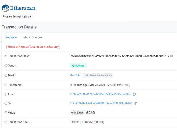

Once all this preparation is done, the actual sending to the blockchain is not different than the blockchain calls in the previous posts (yes, we're back into known domain) .
The web3j lib is used to send the encoded, signed , hash-calculated block to the chain.
Evidence:
