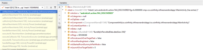

The stack frame, when a card is detected by the phone:
The top method, MainActivity.onNewIntent(), is in the app code. All the rest is standard Android application and event handling.
It shows how this detected event trickles through to a point where you can handle it in the code.
The right half of the image shows the intent's attributes. We got a "tag discovered" message. That makes sense because we just tapped a card on the phone.
The app code then calls Android's setIntent() - the usual first action in onNewIntent(). Then over to the app's own resolveIntent().

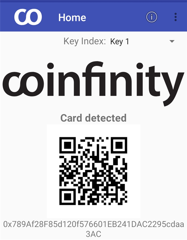

        holdCard.setText(R.string.card_found);

That's then displayed on the app, both as a string and a QR code.
