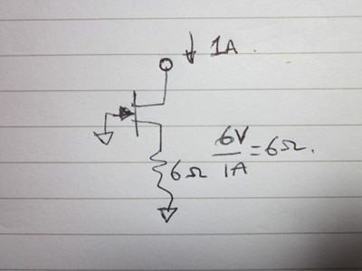

    I like the simple resistor approach, but if you want to have some fun you could get a sample of a USCi UJN1205K and play around with it. These devices can act as current limiters up to 1200 V - without power supplies. I'd like to see what jc2048 would do with it. Maybe devise some zener circuit to get Vgs to be 4 V.

    0 jc2048 over 8 years ago in reply to dougw
    I'm not too good with FETs - when I started out they were a bit exotic and I've never had to use them for anything.
    A constant-current configuration would be like this, wouldn't it?
    The FET shuts down when the gate gets to below about -6V (below the source), so that would regulate the voltage across the resistor to about 6V and keep the current at around an amp.
    It would need a reasonable heatsink - initial dissipation is 400W (on 400V), although it comes down quite rapidly. The 6 ohm resistor would need to be 10W or so.
    That SiC part is very expensive though. You could build a whole constant-current load with a MOSFET for that (including a processor to give you constant-wattage rather than constant-current and other nice things).
