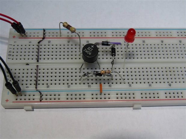

I want to make a capacitor discharge tool for use in an industrial application where the voltage may be as high as 400 volts and I have no idea what the maximum capacitance may be. I have been weighing the pros and cons of different resistor values. Then I thought, Why not ask some of the best engineers on the planet? If you have some insights for me it would be appreciated.
    mcb1 over 8 years ago +8 suggested
    Sounds like it's for a switch mode power supply. Most of them are 470-1000uF, and to prevent damage you'd want to restrict the current to 1A. R= E/I so 400/1 = 400 ohms. Discharge from here https://www…

    Hi Jon,
    As promised I have run some experiments after returning home. I have taken a 2000 uF 200 Volt capacitor and charged it up. The formula for energy in a capacitor is 1/2 CV^2 which works out to about 40 Joules for this capacitor. I built the circuit in my schematic above using a 1/2 Watt 470 ohm series discharge resistor.
    As you can see from the color of the resistor it sustained heat damage after three discharges. Here is a video of the action:
    A second test using a 1 Watt 470 Ohm resistor was able to handle the discharge without any problem. The resistor did heat up but was able to be touched after the experiment. I would estimate it got to about 45 degrees C.
    We were originally discussing a 100 uF 400V capacitor like one we might find in a small switching power supply. The energy storage for 100UF at 400 V is E=1/2CV^2 or 8 Joules. I have no easy way to put 400 volts on a 100 uF capacitor so I decided to simulate this by putting only 8 Joules of charge into the Capacitor in the above experiment. This works out using the formula V = SQRT(2E/C) or about 126 Volts. I will run this experiment using a fresh 1/2 watt resistor. Keep in mind this is an imperfect match as 400 volts from 100 uF would discharge the 8 Joules of energy much more quickly than our 126 volts from the 1000 uf capacitor. Here is a video of the test:
    My conclusion is that the design in the schematic works well and while the 1/2 watt resistor would probably work for the 100 uF 400 V situation it would not be adequate for the 2000 uF 200 Volt capacitor. Jon's suggestion to use a higher wattage resistor is confirmed as the best way to go.

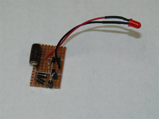

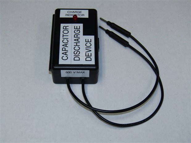

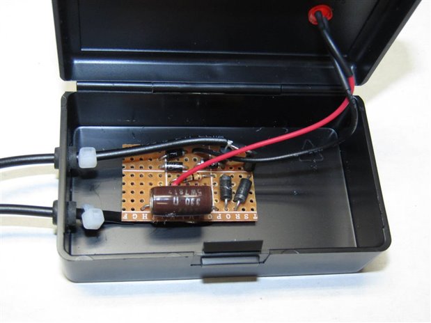

    Last Post:
    I put the unit together this afternoon using the advice and wisdom from my Forum friends. The series resistor was lowered to 330 ohms and wattage increased to 5 Watts. I discharged the 2000 uF 200 volt capacitor several times and I also discharged a 33,000 uF 60 Volt capacitor. Both capacitors were brought to safe voltage in less than 20 seconds. The components were all salvage parts. The bridge diode's specification were increased to 2.5 A 1000V. One problem that I see is that the indicator light doesn't go out until the voltage of the capacitor drops below 3 volts. (90+ seconds on the 33,000 uF cap). Here is what it looks like:
                        Raw Circuit Board
                                  In the Box
    Thanks John
