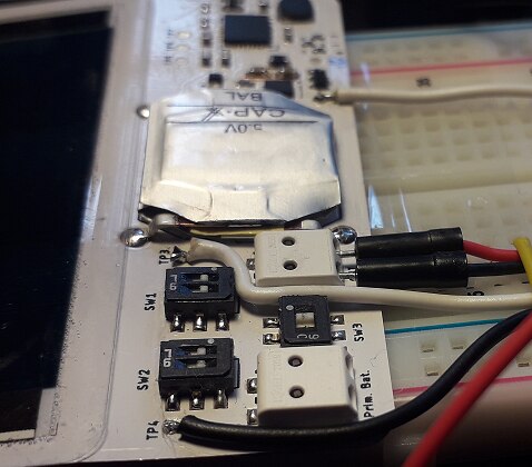

image source: my board, with probe wires soldered to the test points
The Test Conditions
I've set the output to 1.8 V. That's one of the voltages specified in Epishine's draft spec.
Light conditions: my lab during daytime, on a bright summer noon. No direct sunlight or artificial light.
When a load was attached, it was a 590 Ohm resistor. Drawing 3 mA.
No battery.
VCAP recorded with a Kithley DMM6500.
A DMM checking VOUT. This is not recorded, I just used it to see when voltage switched off or on.

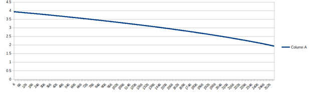

Here is the zoom in of the first discharge ramp, where VCAP starts from 4.5 V, Vout = 1.8 V, Iout = 3 mA
data range in sample spreadsheet: $supercap1.$A$19001:$A$23245
Start time: 3839.588863681 s
End time: 4697.276276045 s
duration: 857.687412364 s
This is 1.287 mWh.
Then the next discharge phase is one where we the load is attached and the design immediately start to take power when VCAP reached it's minimum: 3.9 V
data range in sample spreadsheet: $supercap1.$A$27185:$A$29750
Start time: 5493.527778257 s
End time: 6011.899451787 s
duration: 518.371673529999
That's 0.777 mWh.
