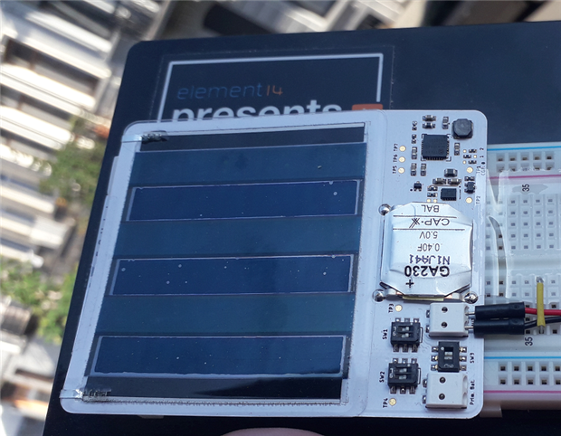

The Evaluation Kit
The kit is named "Evaluation kit for Epishine Light Energy Harvesting".
It's part solar cell, part energy collector.
image source: me
The energy collector is a circuit that will accept very low energy input (in this case, a small solar cell), and collect that energy in a super cap.
Once the collected energy is sufficient, you can use it to power an electronic circuit.
It can - temporarily - provide decent power. Way more than what the lower energy source by itself  can deliver.

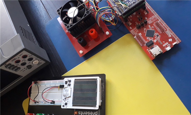

How to Evaluate the Kit?
I'm going to focus on the electronic performance.
  • Charging profile
  • How it behaves under load, with and without light
  • Discharging profile
  • an application
If you have specific requests, put them in the comments below*
Now off to the real work
image source: me
*no promises - but if it fits the design's goal and ignites my interest, yes please
