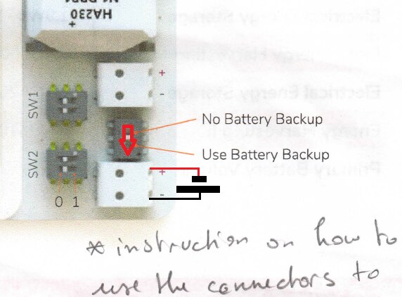

In this post, I'm checking the behaviour when you provide backup coin cell.
The setup is identical to the previous tests: 1.8 V output and 590 Ohm load. But with a 3 V coin cell added to extend the uptime.
source: annotated draft product brief
What this achieves is that, when the supercap voltage drops to 3.6 V, the circuit will use the coin cell energy to recharge the cap back to 3.9 V.
That extends  the time that the circuit can keep your device powered, even without light source.

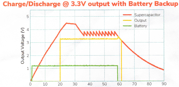

The Epishine example uses 3.3 V output. I did the test with 1.8 V.
source: draft product brief, with a 3.3 V output.

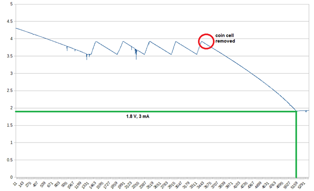

Here's my measurement. Completely as expected.
The e-Peas solar harvesting IC is doing exactly the same as in Epishine's setup.
When the VCAP drops to 3.6 V, the backup charger becomes active and pushes it back up to 3.9 V.
It keeps doing that as long as there's energy in the battery and VCAP hits one of the thresholds.

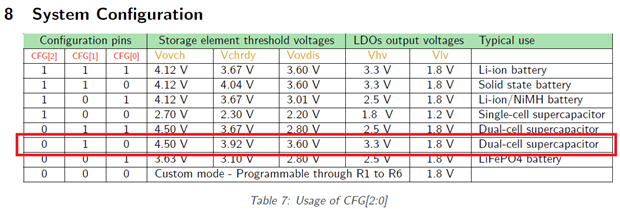

If you're wondering where these voltage levels come from, check the board configuration:
source: e-Peas AEM10941 datasheet

    Jan Cumps over 6 years ago in reply to DAB
    The solar cell does it.
    In this special scenatio there's an additional coin cell that will help if there's not enough light available (or not long enough) to keep the device constantly powered.
    DAB over 6 years ago in reply to Jan Cumps
    Hi Jan,
    I am just looking at your charts and watching the charge/discharge cycle with a sustained 3.3 v out.
    You say the battery recharges the supercap, but I would expect the solar cell to do that if the circuit has more power than the load uses or have I missed something?
