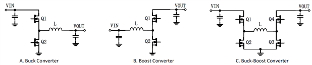

Figure 1: Bidirectional DC/DC converter topologies
Typical non-isolated bidirectional converters include buck, boost, and four-switch buck-boost. A buck converter may run as a boost converter in the reverse direction. Conversely, a boost converter may run as a buck converter in the reverse direction. A four-switch buck-boost converter runs in either two-switch buck mode or two-switch boost mode, and it also effortlessly functions in the reverse direction compared to a standard single buck or boost converter.
Figure 1 illustrates a basic bidirectional DC-DC converter circuit. It is an anti-parallel combo of buck-boost converters. During step-up operation, Q1 conducts by the control signal's duty cycle, while Q2 is in non-conducting mode. In step-down mode, Q2 conducts as per the duty cycle, and Q1 ceases. A short dead time is allotted between both operations to avoid cross conduction. Figures 1A and 1B reveal a non-isolated half-bridge bidirectional DC topology. This topology is a simple one, with better efficiency. Figure 1C topology is produced by cascading the buck converter with a boost converter. Since all four quadrants are possible with this topology, such a topology functions as buck mode and boost mode in both directions. Four-quadrant operation makes this the most flexible option with a few limitations, such as a greater number of switches producing increased switching losses, complex control algorithms, and additional turn-on losses due to reverse recovery of diodes.

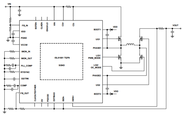

Renesas has integrated bidirectional control into its latest controller, enabling easy implementation of on-the-fly reverse-direction power flow and control. They offer a wide range of bidirectional controllers, and the ISL81801 is a notable example from the company portfolio. We will now discuss this 80V Bidirectional 4-Switch Synchronous Buck-Boost Controller
Figure 2: ISL81801 - 80V Bidirectional 4-Switch Synchronous Buck-Boost Controller  Buy Now
The ISL81801 is a bidirectional 4-switch synchronous buck-boost controller with peak and average current sensing and monitoring at both ends. It has four independent control loops for input and output voltages and currents. Inherent peak current sensing at both ends and cycle-by-cycle current limit guarantee high operational reliability, by providing instant current limit in fast transient conditions at either end and in both directions. It also has two current monitoring pins at both input and output to facilitate Constant Current (CC) limit and other system management functions. CC operates down to low voltages to avoid any runaway condition at overload or short-circuit conditions.
In addition to multilayer overcurrent protection, it also offers full protection features such as OVP, UVP, OTP, average and peak current limit on both input and output to ensure high reliability in both unidirectional and bidirectional operations. The unique DE/Burst mode at light-load dramatically lowers standby power consumption with consistent output ripple over different load levels. It uses a proprietary buck-boost control algorithm with valley current modulation for Boost mode and peaks current modulation for Buck mode control. The controller, with a wide input range from 4.5V to 80V and output voltage, ranges from 0.8V to 80V, is suitable for industrial, telecommunication, and other industrial applications. It comes in a space-conscious 32 LD 5mm × 5mm TQFN package, or an easy-to-assemble 4.4mm × 9.7mm 38 LD HTSSOP package. Both packages use an EPAD to improve thermal performance and noise immunity. Low pin count, fewer external components, and default internal values make it an ideal solution to market simple power supply designs. Figure 3 shows a typical ISL81801 application circuit.
Figure 3: ISL81801 Typical Application Circuit

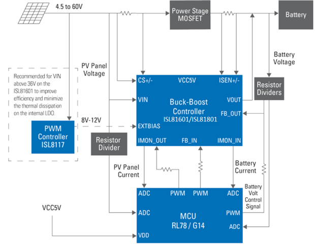

As an application, bidirectional DC-DC controllers are used to charge high power (1000W) outdoor power banks through a car charger or a solar cell (photovoltaic) with MPPT (Maximum Power Point Track) functionality. Solar cells, however, present challenges due to wild swings of output voltage- an effect of solar panel temperature, load, and the amount of solar energy directed towards it. The solution takes the form of an ISL81801 buck-boost controller integrated application circuit, as depicted in Figure 4. It can charge a swathe of battery voltages, even if the solar panel delivers an output voltage much lower than its nominal output. With the addition of RL78/G14 MCU, it monitors battery status and inhibits battery overcharge. The MPPT firmware inclusion enables the RL78/G14 to control the ISL81801 and maximize solar panel efficiency. An optional DC/DC (ISL8117), contingent on solar array voltage, can be fitted to improve efficiency in higher voltage applications.
Figure 4: Bidirectional buck-boost converter application with PV Panel
