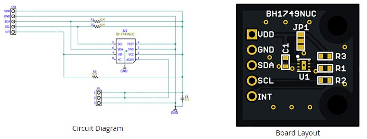

Evaluation Board
Similar to the other sensors I reviewed, the board has the sensor and a bypass cap.
There's the optional footprint for the 2 I2C pullups and a jumper to allow you to change the i2c address.
image: ROHM website

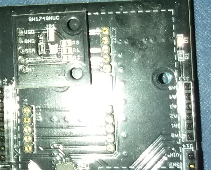

I haven't discussed the jumper system on the i2c evaluation boards yet, although we also have this on the Magnetometer shield.
By default, the address pin is (for this one) connected to VDD by a tiny copper trace.
To change the address, you have to rip that trace and solder a bridge between the address pin and ground.
Unfortunately, the PCB uses black solder mask, and even with a magnification glass I can't see where the connection between the default pins is made.
It looks like it's between the two pads of JP1, but maybe it isn't. That trace seems to wander off to somewhere.
Black solder mask and no published PCB design makes it unnecessary difficult to find out where to cut.
The default address, as configured on the module, is 0x39.
The interrupt pin, connected to Arduino D2, is worth reviewing. It can be set to react on one of the RGB colours.
I'll look into it in the next section.

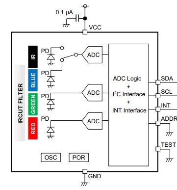

Colour Sensor BH1749NUC
There are four light detecting diodes on the chip, capped with a transparant window.
There are three ADCs. The IR shares one with blue. The IC can work in IR reject mode, for ambiant light measurements.
image: block diagram and interrupt mechanism from ROHM datasheet

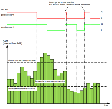

The interrupt can be set to any of the three visible colours.
You can set the threshold for that trigger, then react on that in your code.
You release the interrupt yourself from firmware.
The number of samples that have to exceed the threshold before triggering can be configured via i2c.
The example sketch and library don't use the trigger.
