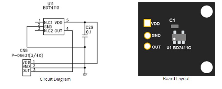

Evaluation Board
The board just has the sensor and a bypass capacitor.
Very straightforward.
Sensor Performance
For this part of the review, I tested the sensor without the shield. VDD is 5.0077 V
Without magnet in the neighbourhood: 5.0059 V
With magnet in reach: 0.0003 V
