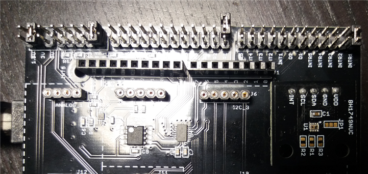

To make the example work, you have to help the interrupt pin a little.
In this explanation, I assume that you use the unchanged example from Adafruit. and that you dock the colour sensor evaluation board in i2c dock #1 as per instructions. The Adafruit code listens to D2 for Interrupt 0;
Also as per instructions, put a jumper on INTR1 on connector J3. This ties that pin to Arduino D2, so that the Arduino INT0 can be used.
But that pin - going to the volatge translator IC - needs a pull-up. To get that extra omph to help the signal pull up, you can jump INT1 on connector J16. That adds a pull-up resistor.
The Adafruit example works just fine then. When the red component of your light drops below the low threshold or jumps above the high threshold, the serial monitor show measurements. If the red component is between both thresholds, nothing happens.

It's easier to dock the board in i2c location #3 and put the jumper of J3 on INTR3, the jumper of J16 on INT3. That way the interrupt pin is not also connected to D0 on the Arduino (see this post to check how things are interconnected on this shield). You have a pure situation where only D2 is connected to the interrupt pin.

    I found a way to make the interrupt work, after mapping the pins of the SensorShield out (ROHM SensorShield V3: Map PINS to Arduino).
    It's
    1: depending on where you dock it. I docked it at i2c dock #1.
    2:Then, as described in the instructions, also put jumper on conncetor J1, Pin INTR1.
    3: also pull J16 INT1 high by placing a jumper.
    A bad foto tells a few words:

    Jan Cumps over 7 years ago in reply to Jan Cumps
    ... I just learned - by beeping the SensorShield out, how the interrupt jumpers work.
    You have to set the jumper depending on the docking position where you plugged in the sensor.
    That pin is then linked to Arduino D2.
    If you use the INT?x pi, the voltage is translated. If you use the INT?, it's a direct connection to pin D2.
    Trying again now ...
    edit: J3 ties to D2, J1 ties to D3 of the Arduino.
    D1 on the interrupt selector is pin 3 of J11, D2 is pin 4, with the voltage translator in between.
    D1 on that J11 is also directly connected to arduino D0, and D2 to Arduino D1.
    A bit of a bummah, because D0 (and also D1) of the arduino UNO is hard to drive, with the USB part attached to it and pulling that pin high via a 1K resistor...
