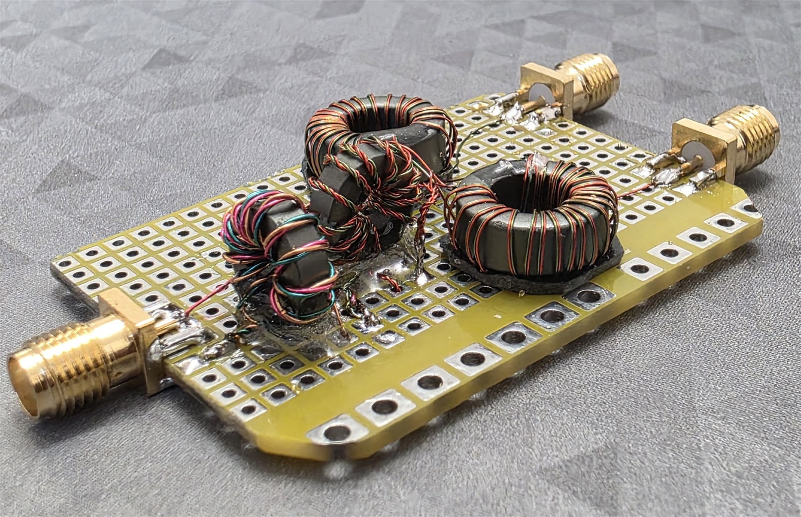

A fellow radio enthusiast was looking for an RF power splitter, and of course these things are not easy to obtain at short notice; often they need to be ordered from overseas (I’m not aware of a local source), and they cost a lot!
I decided to give it a shot, and it was a one-day project, involving a bit of reading up, winding coils, and sitting in front of the VNA!
This very short (well, it was when I started it! it kind of grew..) blog post documents what I did, in case anyone else wants to make one, or to see how a VNA can be useful.

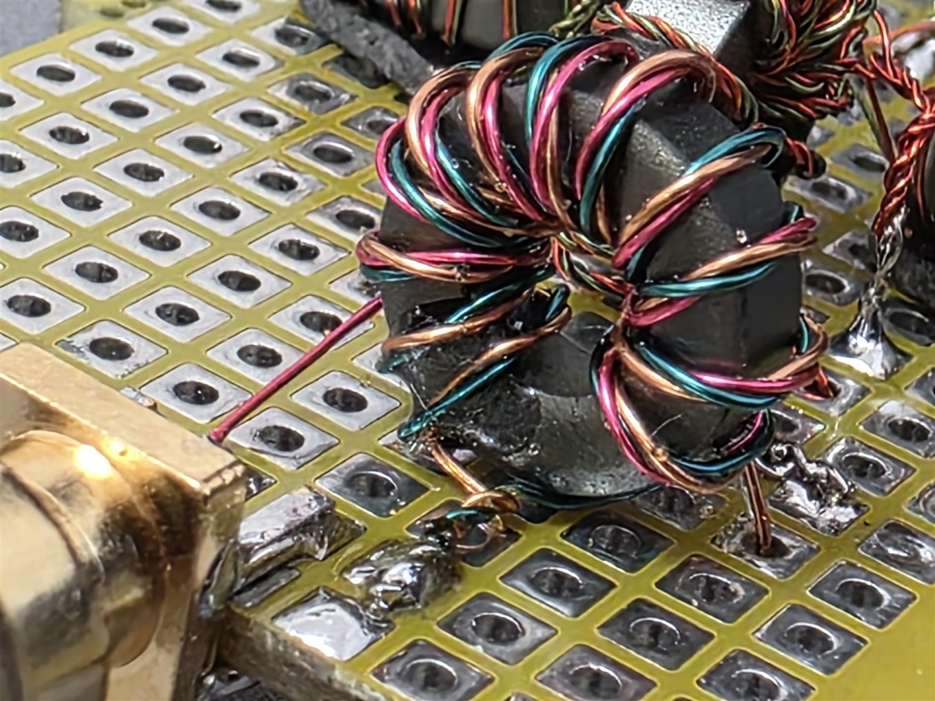

The photo might look scary due to the amount of windings, but everything is easier in smaller pieces, and actually this project is 3-in-one, each of the three sub-systems serve a purpose and can be individually tested.
Even if you’re not interested in a power splitter, but are interested in a balun or impedance transformation or just using a Vector Network Analyzer (VNA) then there may be something of interest in this blog post.

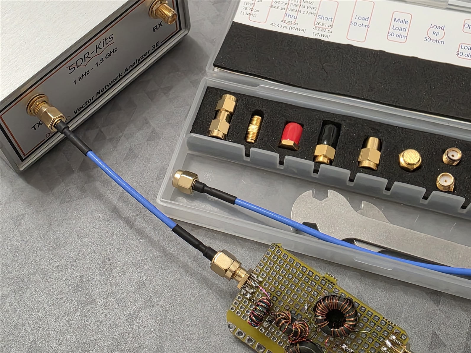

Very few tools were used – no LCR meter or oscilloscope or even spectrum analyzer or signal generator was needed. In fact, only a VNA was used, and it can be a very low-cost one such as NanoVNA, which is a surprisingly capable instrument.
If you're new to VNAs, what the VNA instrument does is generate a frequency sweep signal, and that travels out to the device-under-test. If that device has an impedance that matches 50 ohms, then no power will get reflected back, and the VNA looks out for the reflected power, and the phase shift, and uses that information to display (in various charts) the measurements across the frequency range of interest. It turns out that the measurements can be represented in different ways, for instance, as an impedance. Most VNAs will also be able to show what comes out of the other end of the device-under-test too, and that's useful to see how much loss occurred (again at different frequencies) for RF transiting through the device.
The basic procedure was to build things one subsystem at a time, and measure that subsystem in isolation, using the VNA. The steps are:
(1) Power up the VNA, and set it to the frequency range of interest (1-30 MHz in my case)
(2) Load your Calibration Kit details into it (if the VNA supports it). The photo here shows my cal kit; usually the bits and pieces can come with the NanoVNA (an extremely basic cal kit, but it will be fine for the frequencies of interest in this blog post), but for other VNAs, it is a separate purchase.
(3) Attach a short SMA cable (male-to-male SMA cable) to “Port 1” (VNAs usually have ports with specific numbers, and port 1 always provides the most frequently used capability called an S11 measurement.
(4) Make the VNA aware of the cable length (otherwise the measurements are meaningless) – this is usually done by performing a calibration (which involves applying the calibration kit pieces to the end of the SMA cable when requested.
(5) Attach the wound component to the end of the SMA cable, and this is easiest if you have a female SMA connector that you can solder the component on to. The photo below shows a few methods that could be used. The leftmost example uses a bare connector, and the component happens to be wired for measuring inductance for common-mode signals. The rightmost example shows a reusable prototype test board. The thing being tested there is what percentage of power goes into the load at the other end (a resistor has been soldered there) and what percentage is reflected.
(6) Run a scan, and tell the VNA how you want the results displayed! Sometimes a Smith Chart is helpful, and other times you might want a normal x-y chart. The blog post shows both being used.

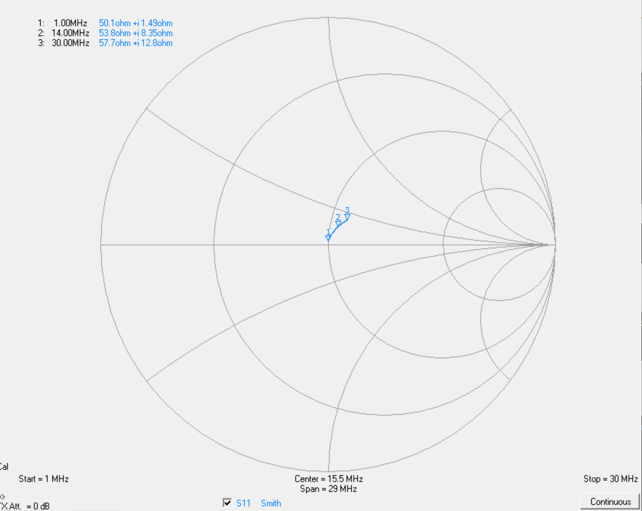

To construct the splitter sub-system, I built one of the coil systems, and then tested it with a vector network analyzer called VNWA (another option as mentioned earlier is NanoVNA; it would be very capable of these measurements too).
I was interested in two things;

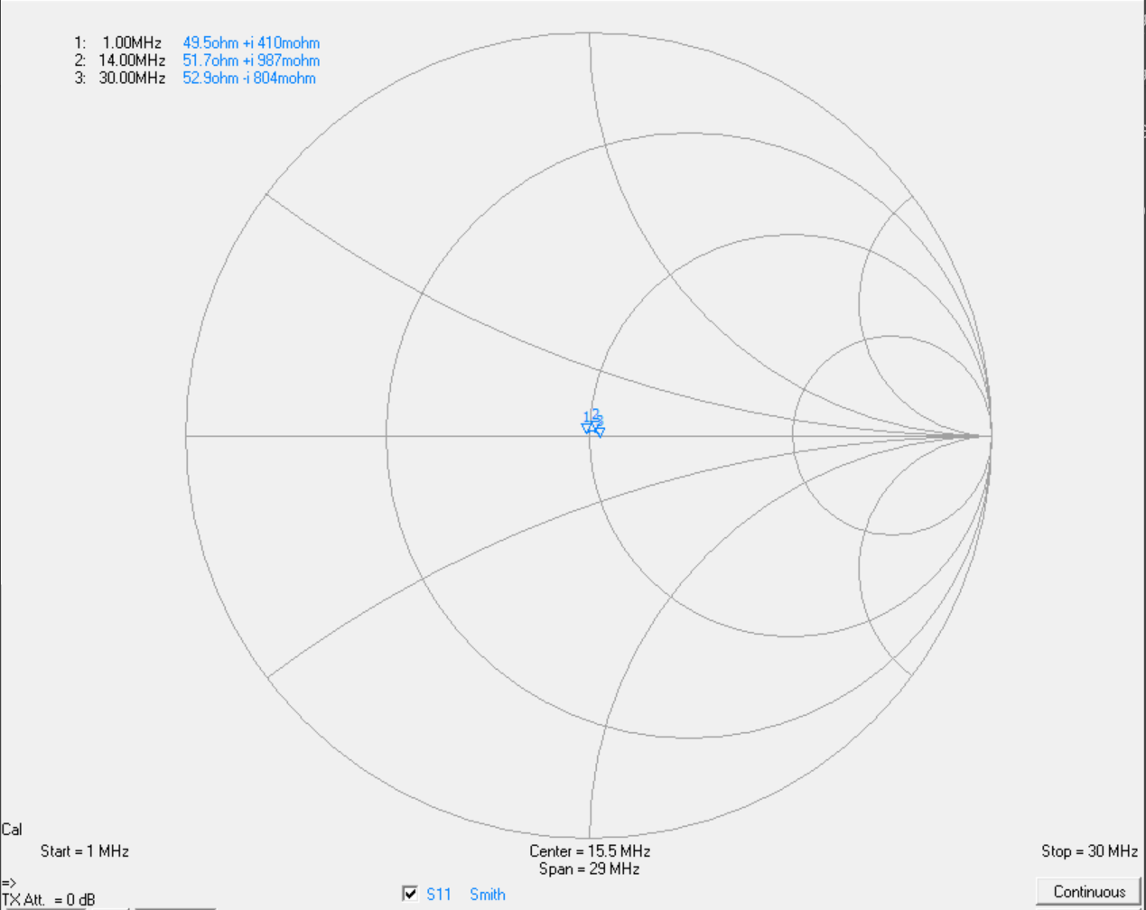

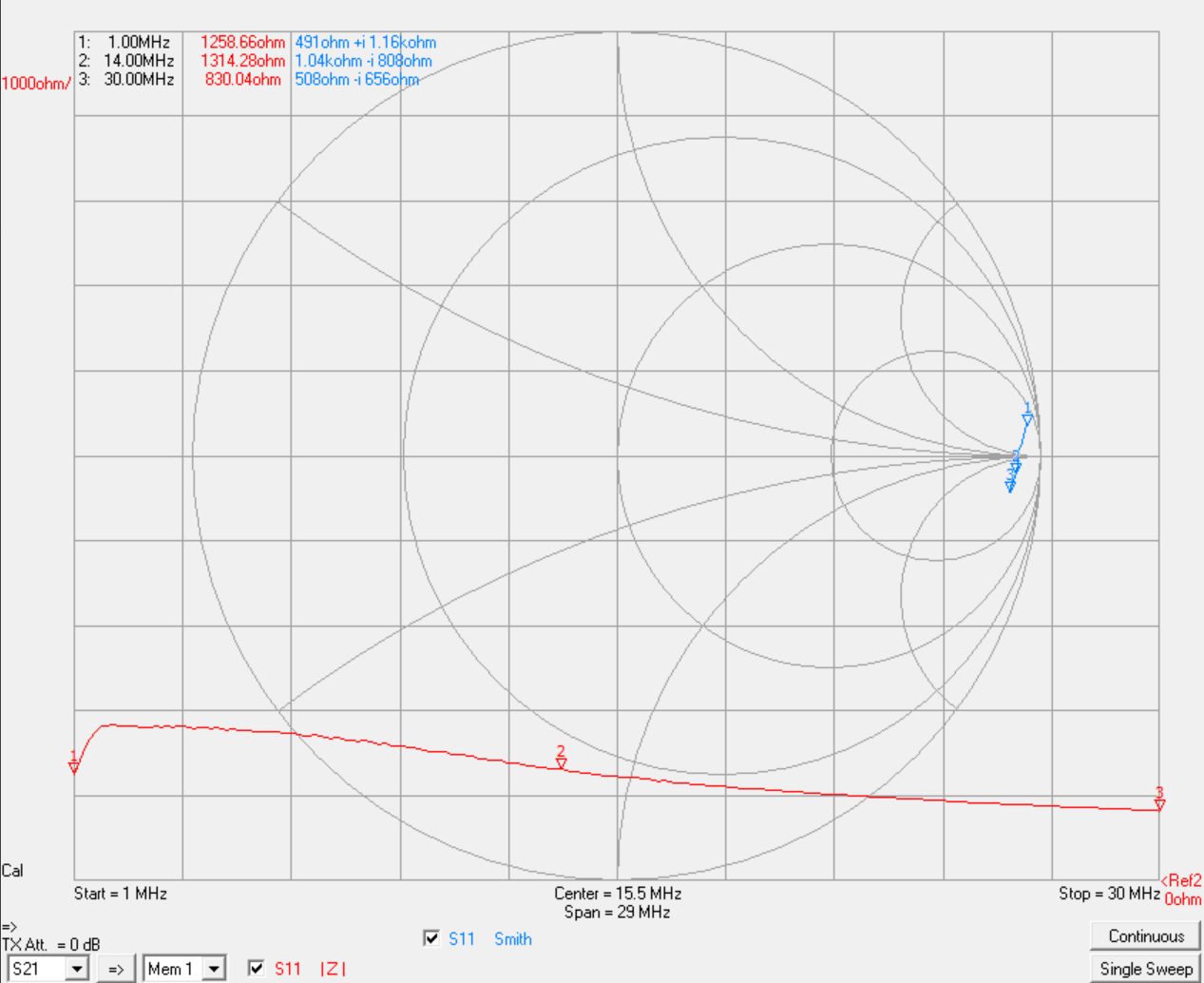

(a) the common-mode impedance, which ought to be at least 500 ohm (i.e. ten times 50 ohms, although I prefer to aim for at least 20 times) at a bare minimum across the frequency range, and ideally higher, and
(b) the match to 50 ohm.
Both of these things were tested between 1 and 30 MHz.
This chart has markers at 1, 14 and 30 MHz. The red line here shows the common-mode impedance, and at 30 MHz, it is listed as 926 ohm, so I was happy with that. The blue line is above and below the horizon slightly, so there was resonance at some point (also can be seen from the red line going extremely high).
Here’s a chart showing the impedance when the other end of the windings are terminated with 50 ohms. As can be seen, the result is near-ideal, the plot is concentrated precisely at the 50 ohm center location in the Smith chart, across the entire frequency range.
I repeated these measurements for a second coil system, so that I could be fairly sure both were reasonably matched. Then, I assembled the circuit, and put it to one side, since further tests for this would be best at the end.

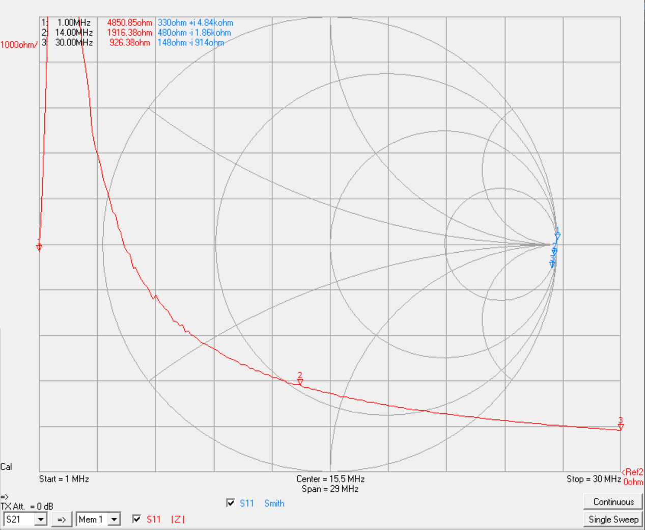

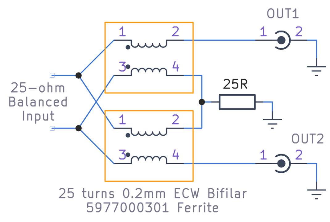

In order to get an unbalanced input (referred to ground), I prepended a balun to the section above. It’s normally fairly straightforward to construct this, you just need twisted wire wrapped around the ferrite enough times to build up a reasonable common-mode impedance. However, in this case, the balun was needed for 25 ohms, not 50 ohms, and that’s a little more tricky than usual, because that means the wire needs to be twisted a lot to bring the characteristic impedance of the transmission line down. My solution was to use four wires, not two, in the hope that the coupling would be physically closer. It did work, but I had two attempts, and picked the one with the best results, since I didn’t know precisely how much to twist (the answer was, the amount of twisting was extremely high, about one twist every two millimeters).
Just as with the previous section, I measured the common-mode impedance, and it was substantially greater than ten times 25 ohm:
I attached a 25-ohm resistor at one end of the windings, and the VNA to the other, and made an S11 measurement, and it was not bad (it was slightly worse the first time, but I redid it with tighter twists). I suspect I still have not achieved 25-ohm characteristic impedance, which may be causing the slight degradation at higher frequencies.
After this, although I now had an unbalanced interface, I still had the problem that the input impedance was 25 ohm, not 50!
Here's a photo of the balun (taken much later, after it was assembled into the complete system). You can see the four windings were quite tightly twisted together.

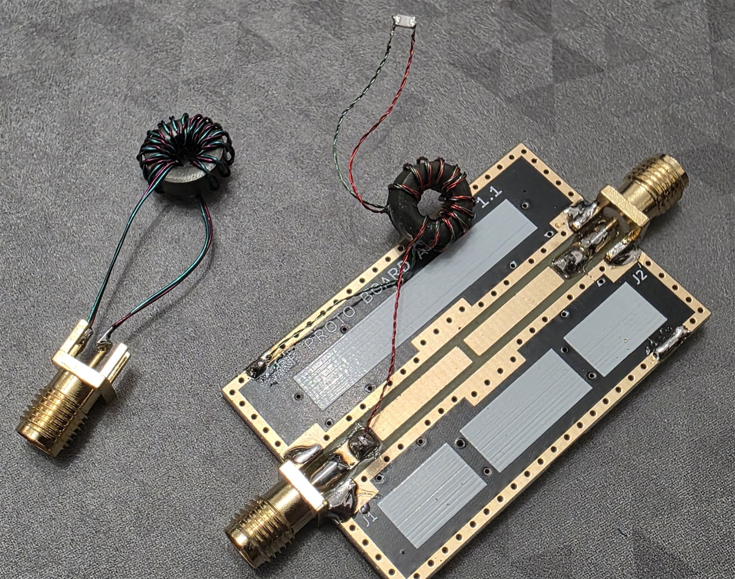

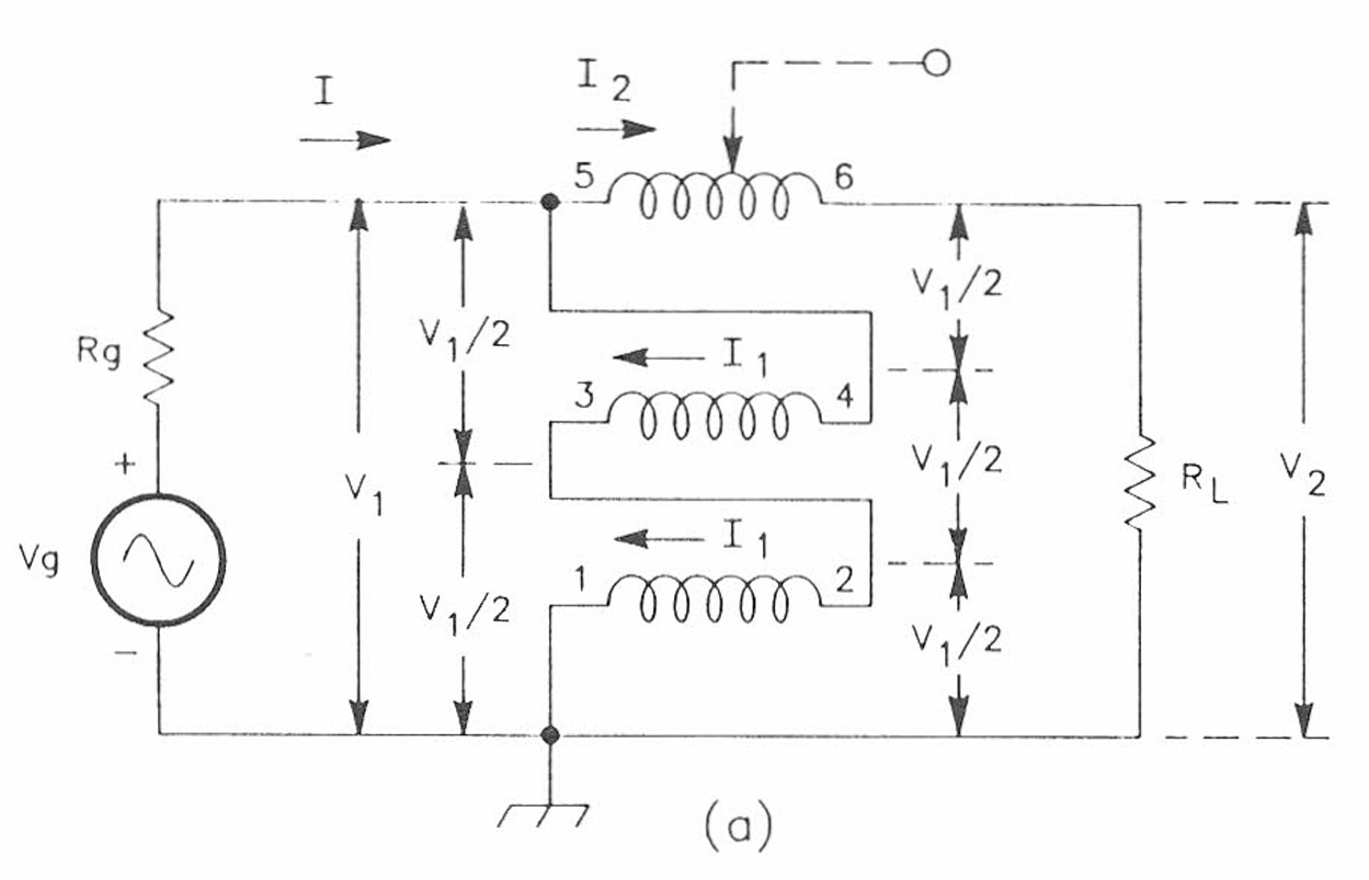

Referring again to literature, there’s a book by Sevick called Transmission Line Transformers, which details a variety of such transformers. One was particularly interesting (it is also in this PDF on page 40); it involves a trifilar winding, where one of the three windings stops early, 80 percent of the way through. I gave it a try; actually, a couple of tries, just like all the other steps in this project! and it worked remarkably well.
Image Source: Transmission Line Transformers by Sevick

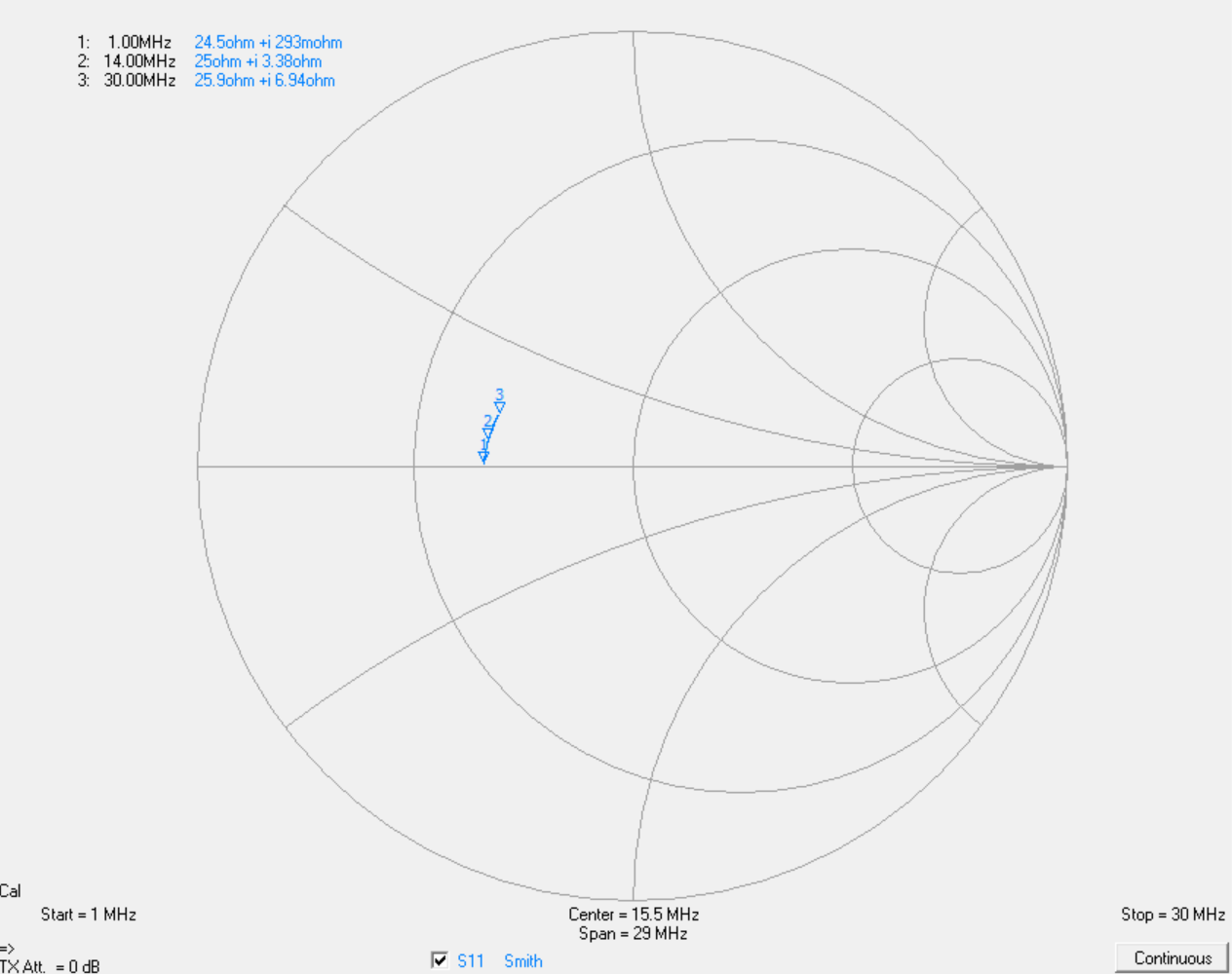

To test it, I connected the 50-ohm side (the side with the tap at 80%) to a 50-ohm load. I connected the 25-ohm side to the VNA, and I expected to see 25 ohms being measured. The result was smeared slightly into the inductive half of the Smith chart at higher frequencies, but overall I thought it was very acceptable.
As another test, I wanted to see what the insertion loss would be so I removed the 50-ohm load and connected that to Port 2 of the VNA, so that the VNA could perform a S21 measurement. I forgot to take a screen capture, but the result was a near-flat 0.7 dB loss. However, 0.5 dB of that is expected to occur, simply because of the mismatch. Therefore the discrepancy from the expected result was just 0.2 dB.
Here's a closeup of the impedance transformer. The pink wire on the left side is the 80% tap connection.

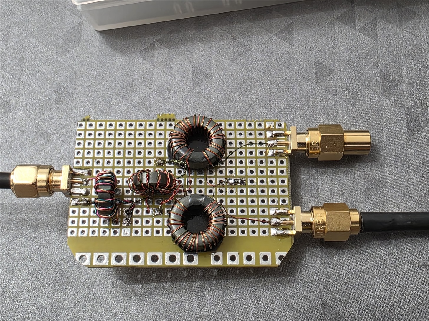

The final circuit diagram of the entire system is shown below.
I assembled it up on a small piece of prototyping board which had a ground plane on the underside. Time to test it!
For a first test of the system, I attached 50-ohm terminations to both outputs, and then connected the input to the VNA. The result looked good to me.
Next, I removed a terminator from one of the outputs, and attached the output to Port 2 of the VNA, and measured the insertion loss; it ought to be close to 3 dB. You can see the insertion loss show with the dark blue horizontal line in the screenshot below. Notice how good the S11 turned out, it’s almost a dot at the center of the Smith chart.
I repeated for the other output, which had very similar insertion loss. Notice the S11 measurement isn’t quite as good, but still acceptable. I think this shows that the two ferrites perhaps have to be wound extremely identically.

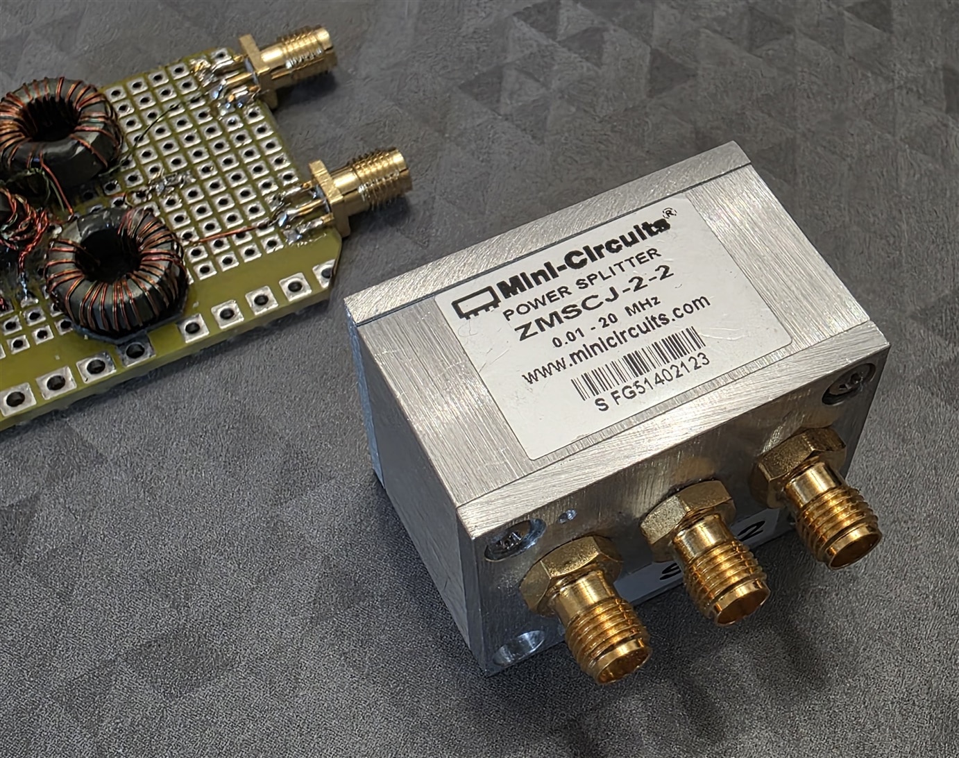

How does this compare to a commercial splitter?
I have a Minicircuits ZMSCJ-2-2 which costs over £100/$100 these days. Compared to that, the DIY version covers a broader range, and the phase error is lower. However, importantly, the Minicircuits version has a slightly lower typical insertion loss (although the specified maximum is not much different to what the DIY version achieved, and, up to 5 MHz or so, there is lower loss with the DIY version compared to the Minicircuits version typical value). With a bit more experimentation there's no reason why it shouldn't be able to be improved further.

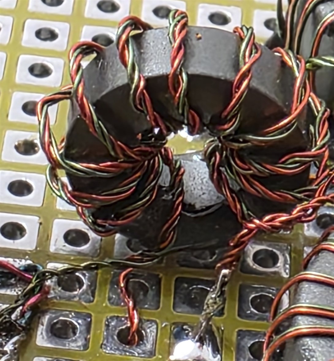

    shabaz 29 days ago in reply to Jan Cumps
    You're right..
    Both of these transformers had some improvement, but the left one was the winner. And it's way easier to twist when the wires are thinner, even though it was a bundle of twice as many wires. The insertion loss improved across most of the range, although toward 30 MHz it was negligible improvement.
    Also, when measuring the 25-ohm side impedance (by attaching a 50-ohm termination to the other side), it was a fraction worse than before. I couldn't understand it.. Since that blue trace is above the horizon line, that's unwanted inductance, but of course a good transmission line should look like a pure resistance.
    I removed one turn from all the windings (to see if the improvement might be 10%!), but the difference was unnoticeable. I concluded the transmission line was good with all those twists.
    Then I tried shortening the protruding connections on the transformer, and noticed that made a difference! I had not expected such a change since 30 MHz is not an extremely high frequency, but it did have an effect, and I think the biggest improvement was by shortening the lead that went to ground.
    In the end, the transformer looked like this, tacked down close to the test PCB.

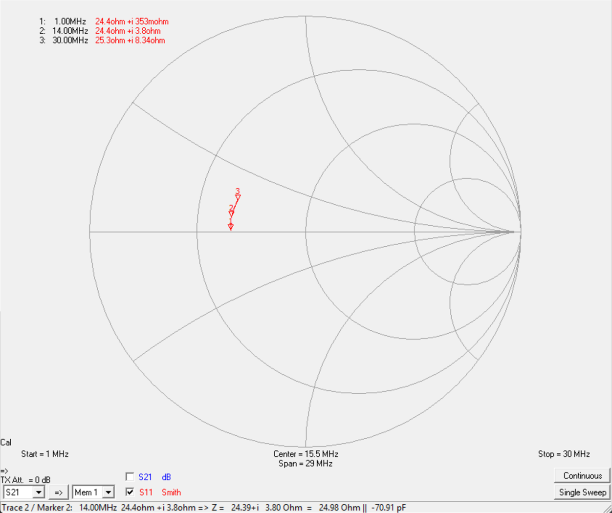

    It made a big difference, the red line was what I was originally seeing with the winding that was used in the blog post, and the blue line shows the new transformer.
    AI-generated summary of that blue line; it is almost precisely 25 ohm at ~15 MHz, and the reactance is halved compared to before!
    The measured "insertion loss" values are expected to be ~0.5 dB for a 100% efficient transformer (because the VNA doesn't have 25-ohm ports, in reality the loss is far lower, and transformer efficiency is now extremely high.
    Unfortunately this was just an academic exercise for now, since I no longer have the rest of the circuit to try to swap in this new transformer. Anyway, lesson learned, keep those transformer wires short, especially to the ground plane, and get an extremely good twist on those wires, thin hexafilar wire was beneficial. If I was to ever build this again, I'd do it on a PCB to be able to keep short wiring, whereas the perfboard layout was more spread out.
    If anyone replicates this: this improved impedance transformer used the slightly larger 5977700301 core, instead of the 5977700201 mentioned in the blog post, and instead of 12 turns and 10 turns for the ~80% tap, I removed one turn so that is 11 turns and 9 turns.

    It has been bugging me, how to improve the impedance transformer. Here are two new attempts.
    Both of these are on a slightly larger core, to give the windings a bit of space. I kept the same number of windings as before, although technically they could be reduced by a turn or two with the bigger core.
    The other main difference is that the left side one has hexafilar winding : ) compared to the trifilar on the right. The left one has six 0.2mm wires, and the right has the same three 0.3mm wires as before. I wound both of these transformers with as many twists as I could easily manage, and tried to wind them evenly but it's not easy.
    Place your bets, which one may be better or worse (or whether they will both be better or worse!).
