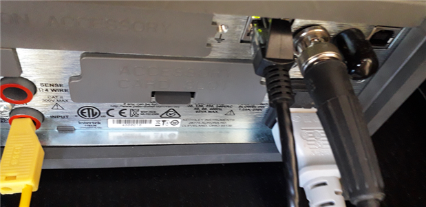

The DSS6500 has a Trigger In BNC connection at the backside. It accepts TTL level signals.
You can (as the label indicates) use this input to trigger activities in the DMM6500.
In this case, I want to take a measurement when 5 V appears on that input.

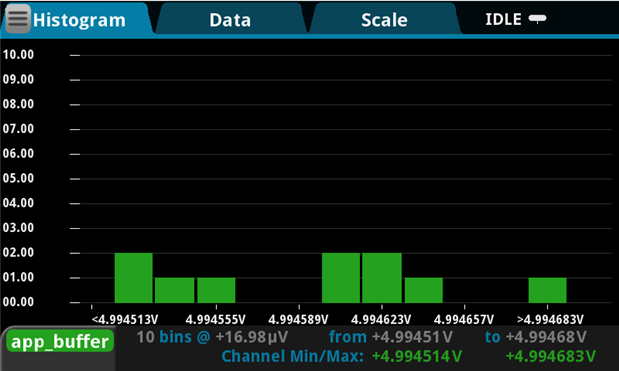

Application Specific Buffer
Although not essential, I prefer to define a dedicated buffer in my script.
There are 2 default buffers that always exist on the DMM6500, and you can use those.
But it's easy to have this little dataset available with exactly the data and format you need.
buffer_size = 10
app_buffer = buffer.make(buffer_size, buffer.STYLE_STANDARD)
app_buffer.fillmode = buffer.FILL_ONCE
display.activebuffer = app_buffer
display.activebuffer = defbuffer1
At the start of the script, the buffer is defined and we ask the instrument to display the buffer values while measuring.
When all is done, we reset the instrument to show the default buffer again.
A better way could have been to store the buffer that was active before we started the script.
origBuffer = display.activebuffer
display.activebuffer = origBuffer

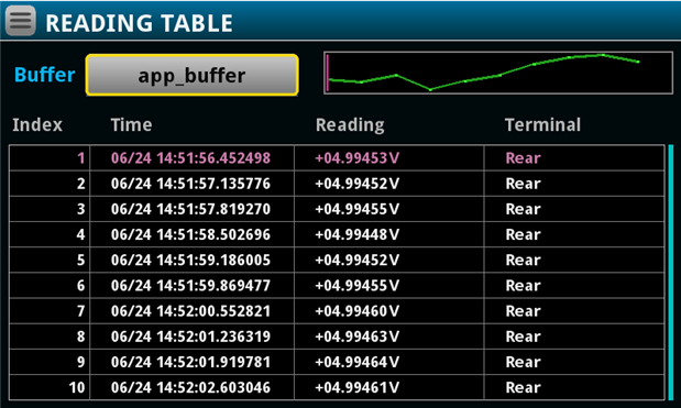

Once the data is in the buffer (10 pulses on the Trigger In connector), the instrument has some nice functions that you can do with the data.

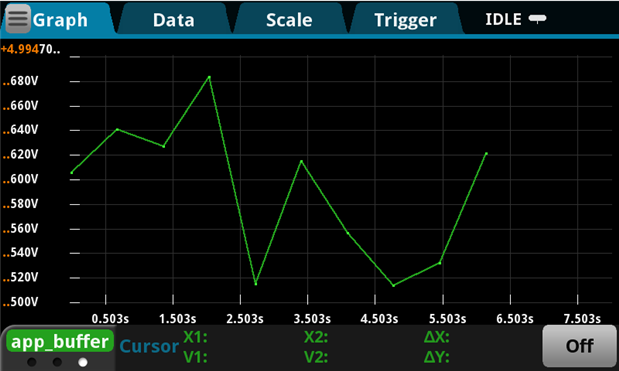

You can display it in table form. The little graph top right shows that same data. When you set the cursor in the graph to a specific data point, that line in the table is highlighted.
You can also load that data in the graph display:
Run it through the histogram view (this is useful when you're matching components, ...):

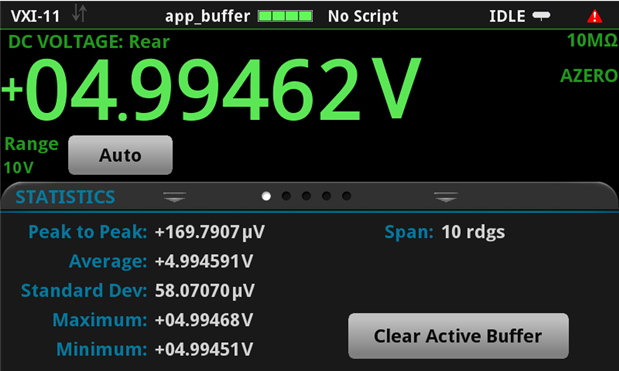

.... and get statistics:
Additional to that, you can also download the buffer, write it to USB. Or do custom calculations, aggregations within your script.

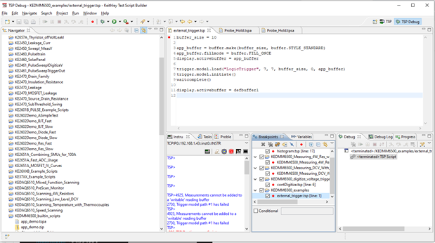

I've used the Test Script Builder to write and debug the application.
You can step through the code, view variables.
To simulate activity on the Trigger In, I used a function generator in TTL mode, set to approx. 1 Hz.

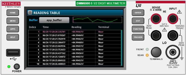

As soon as the trigger model is initiated, it takes a measurement at each rising edge of the TTL signal, then stop after the 10th sample.
The input for the measurement was a fixed 5 V DC power supply.
