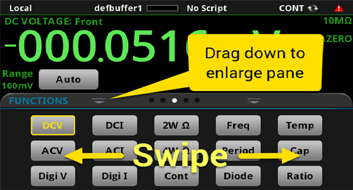

There's a pre-installed app on the device that shows such an instruction card flow, called Instructions.
It's a set of 5 cards that you can scroll to, showing where the main user interface functions are.
Here's an example of one of the instruction cards.
Example

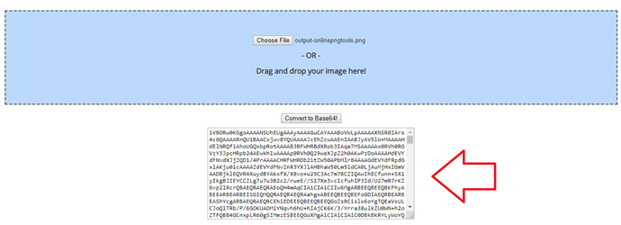

You need to have the image, in PNG format.
An image of 800 * 430 fills the whole width and fits under the title bar.
You have to convert it to BASE64.
Here's a website that can do that conversion online: https://onlinepngtools.com/convert-base64-to-png
Paste the BASE64 content in the application source file that you downloaded from Keithley's website, over the content of the first image.
Put it between these lines of code, replacing anything that was in there originally:

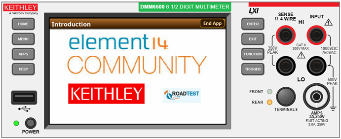

loadimage board2 intro_DMM

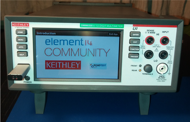

Save the script to a USB stick (.tspa extension). Then press the APPS button, and navigate to the USB.
Then select the app, and RUN it.
You'll see the image you created pop up first. When you press the TRIGGER button, it will navigate to the remaining original tag cards.
Home brings you back to your custom image.
