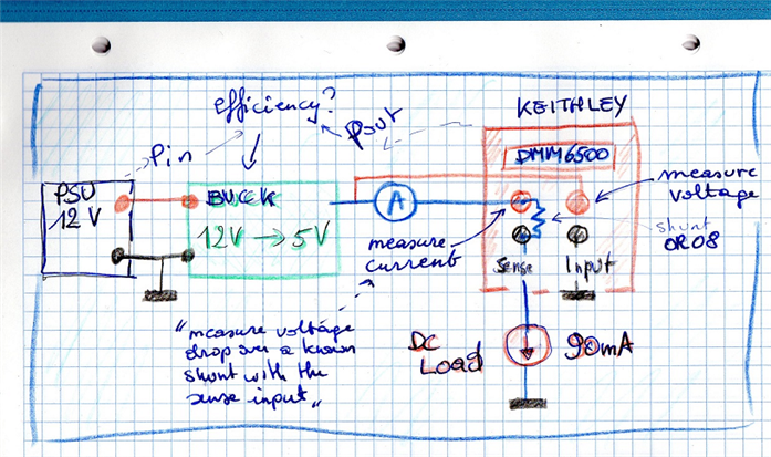

In this post, I test the script to measure DC power. The setup uses the input to measure output voltage of a Buck converter, and measures current via the sense input and a shunt.

The normal inputs of the DMM6500 are used to measure the voltage of a circuit under test.

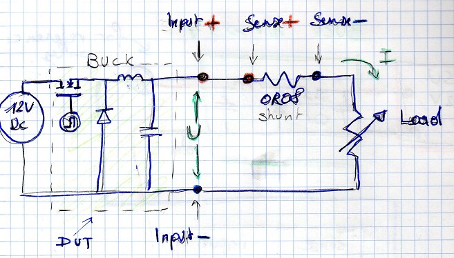

To measure the current, you have to place a shunt resistor over the sense pins, and put that shunt in series with the circuit you want to measure.

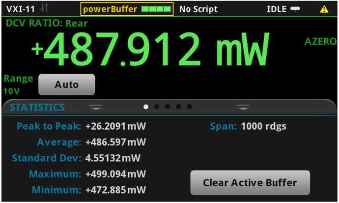

The measurements and calculation are stored in the buffer. The meter displays the active value in the powerBuffer.

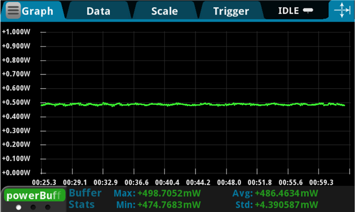

The measurements and calculated power are stored in buffers on the DMM6500. You can use those buffers:
On the instrument, you can use them for graphing,
and to get statistics:

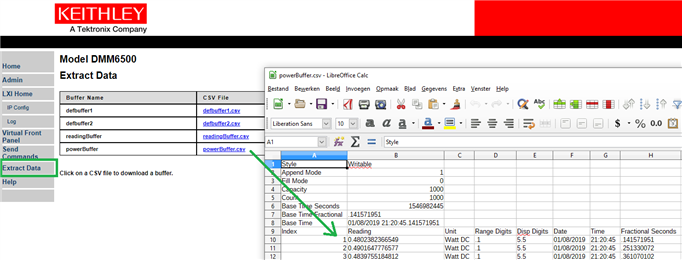

Via the web interface, you can download the buffers as CSV files:

Test Circuit Setup
I kept this as last because it's not instrument related.

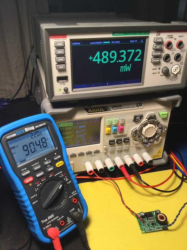

I'm measuring the power at the output of a Buck converter.
The converter is powered by a 12 V DC PSU and outputs 5 V.
There's an amp meter in series with the DMM6500, just for validation. It's not required.
The current is measured with a shunt of 80 mΩ. It's in series with the output of the Buck output (and the DMM). The sense input measures the voltage drop over the shunt.
The load of the Buck circuit is my electronic DC load. It's set to sink 90 mA.
The voltage is measured directly at the output of the Buck.
