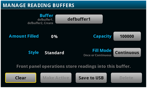

You may want to clear the buffer before you display the table with measurements.
Do that via MENU -> Reading Buffers -> Clear -> Yes

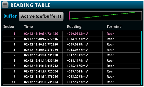

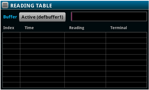

Then switch to the table display.
MENU -> Reading Table

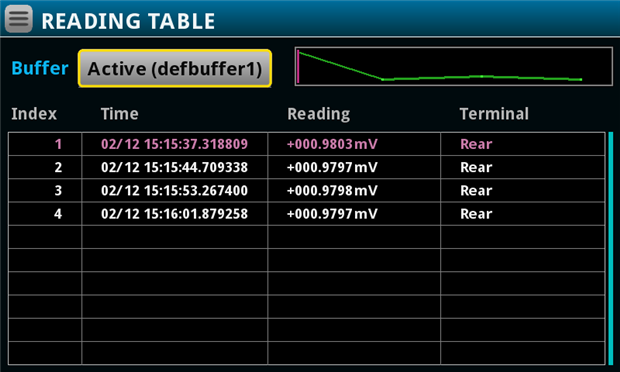

Place the probes on the circuit where you want to make your measurement. Each time you press TRIGGER, a fresh measurement is added to the table.
In the example below, I programmed a DAC from value 100 to 1000, in steps of 100.
Each time I changed the setting, I pushed the TRIGGER button to record the output of the DAC.
The purple line shows where you are on the graph. You can scroll through graph and table.

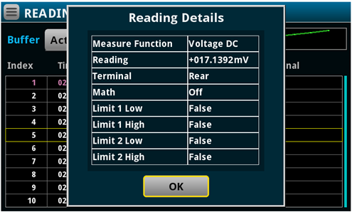

Tapping an entry shows reading details.
