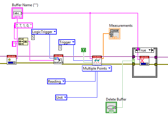

I'm road testing the  Keithley Bench Digital Multimeter DMM6500.
In this post, I investigate how to use the external trigger to start a measurement.
In this post, everything is configured and executed in LabVIEW. In the previous post I used the front panel.
Goal: I want to measure the voltage on a microcontroller GPIO pin just after it is set to high.
Check out the last post for the details.
Set Up the External Trigger with LabVIEW

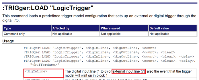

I'm using the SCPI :TRIGger:LOAD "LogicTrigger" command to set up the trigger model.
That one can be used to configure the external input.

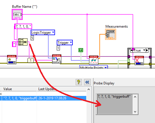

The string I pass to the SCPI call is: 7, 7, 1, 0, "triggerbuff".
parameters:
  1. 7: the external trigger in as active digital input
  2. 7: not used. It enables the external trigger out.
  3. 1: make one measurement
  4. 0: no delay after trigger
  5. "triggerbuff": I created a custom buffer to capture the measurement for this exercise. You can also use one of the 2 standard buffers.

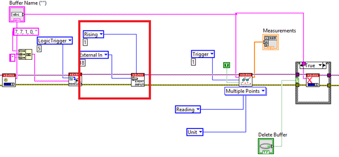

edit: this approach sets the meter up to trigger on the falling edged of the external trigger in. That's not what I want.
I had to add a block to reconfigure to the rising edge.
Here's the addition. The LabVIEW project attached to this post is updated.
I think I found an error in that Keithley LabVIEW Configure Event Input block.
I logged a topic on the instrument's forum: https://forum.tek.com/viewtopic.php?f=617&t=141442

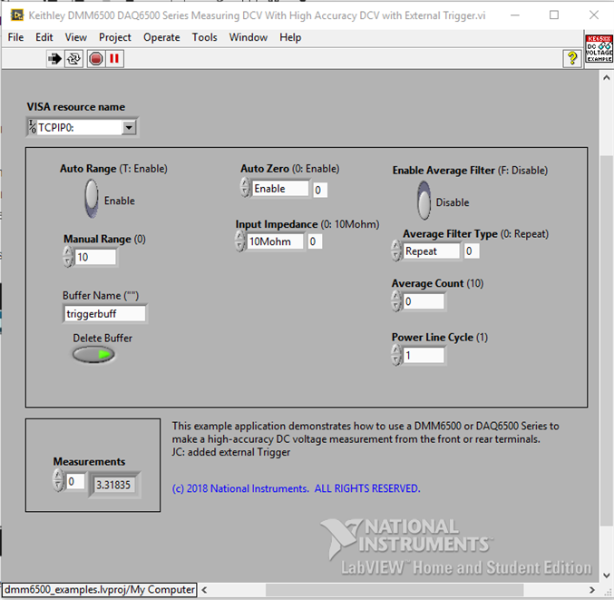

Run the LabVIEW Flow
In this short video you can see the meter display updating in real time when I execute the Trigger Template block in LabVIEW:
This is the form used to execute the LabVIEW flow:
The flow itself - the trigger part of it - is shown at the top of this post.
I adapted the existing Keithley example Keithley DMM6500 DAQ6500 Series Measuring DCV With High Accuracy DCV.
If you want to view the whole flow, I've attached it to this post.

    Jan Cumps over 7 years ago in reply to svasenius
    yes. It’s documented in the post I made on the tek forum: https://forum.tek.com/viewtopic.php?f=617&t=141442
    I changed EXT:IN to EXT
  • svasenius
    svasenius over 7 years ago
    Did you find solution for that triggering bug?
