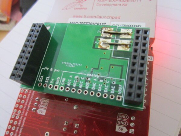

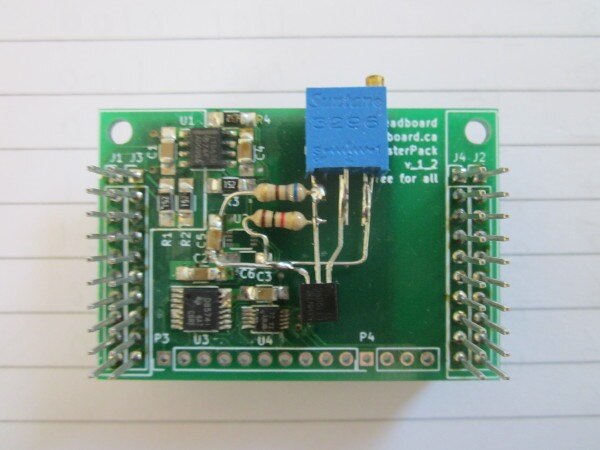

ADC-DAC Board
This is how the ADC/DAC board currently looks. Last year, when I first built it, the 2.048V voltage reference chip was on back-order so I improvised a temporary replacement with a LT1009 (a 2.5V part) that I had so that I could try the board even if the voltages would be wrong. I now have the proper device for U2, so the next job is to remove the temporary parts and see if I can manage to solder it to the board.

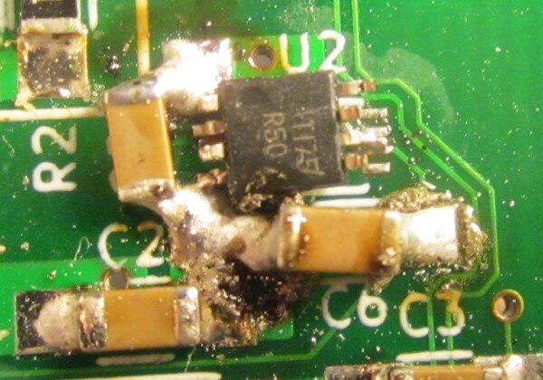

Replacing the Reference

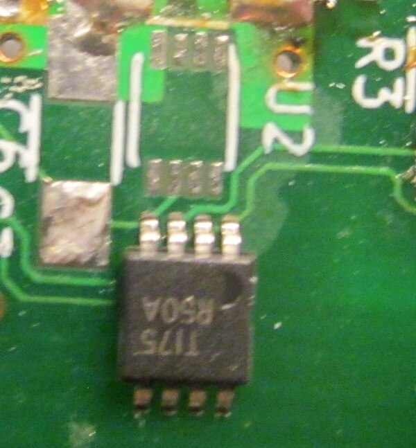

I took off the temporary reference. Now I'm faced with this
At first I thought Farnell had sold me the wrong part, but the code on the top of the package does match what it says in the datasheet, so I guess I need to adapt the package to fit the footprint. Luckily we're only using three of the pins, so I can bend the others out of the way. Maybe.
This is now appears to be a complete mess, though it's not quite as bad as it looks. The unused legs are actually pointing up at the camera rather than down at the board, so there's much more clearance around the three pins that are soldered than it looks. I now see this coming out of the reference (that's measured across the capacitor at the output of the reference) so it's quite close to 2.048V.
In the morning, when my eyes are rested, I'll clean it up a bit and then start looking at the DAC.
First Go at Running the DAC Board
I've now got the ADC-DAC board plugged into the back of the processor board (the LCD display is in the same position on the other side of the board).
Next step is to talk to the load so that I'm in a position to issue SCPI commands. To do that I'm using PuTTY and I've set it up in the way that Jan describes on the main load information blog. After a bit of confusion about which COM port I should be using (not unusual with Windows), I see this
that's the load responding to the 'who are you'?' command, so that means I have usable communication with the load and can start issuing instructions to Jan's software.

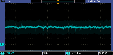

As a quick test, I've just tried sending test values to DAC A (known to SCPI as DAC1)
DEVE:DAC1 0   results in a voltage of 0.391mV at the output pins of the DAC-ADC board (that's the low end of our control range - ideally it would be zero)
DEVE:DAC1 #HFFFF  results in a voltage of 2.0421V (that's the high end - it's a 16-bit converter - and ideally it would be the reference voltage of 2.048V)
The only load is the meter. This isn't driving the analogue board yet.
So talking to the DAC works. That's really good progress (well done, Jan!) because I now have the minimum that I need to control the analogue part.
Here's the low end of DAC A output. I didn't measure all the values, just enough to get the shape of the curve.
So it limits, with a minimum value that's greater than zero, AND there's an offset (if you extended the line down it would be below 0mV at the DAC 0 setting).

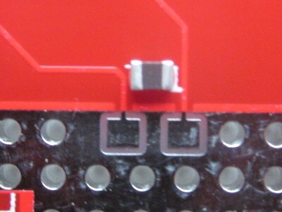

One thing to watch is the thermistor. Here's the bare board with the thermistor placed next to its pads.
There's a real danger of shorting one side or other of the thermistor to the MOSFET drain. I cut across the bottom of the
piece of copper that goes between the pads to isolate it and also did a continuity check after I'd soldered the thermistor to
check that it wasn't shorted to anything and that the thermistor resistance was around 10k (it was).

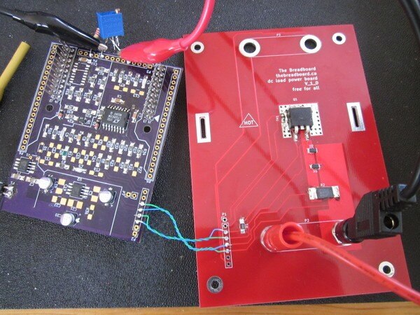

First Test
Here is the analogue board and the output board wired together on the bench. For now I've merely tacked on connections for
the MOSFET gate drive and the sense resistor coming back.
The input voltage comes from a 10-turn trim pot. The voltage derives from the 5V supply that comes out on the header.
It's not very easy to see in the photo but the pot is across a 1N4148 diode, so the range is approx 0 to 0.7V. I've got my
best meter (the Fluke) measuring that. On the output side I've got a cheap handheld meter measuring the current. That has a
400mA fuse on the low current ranges, so I've also got a series resistor so that the output current can't exceed the fuse
rating with the 5V supply that's supplying the output side. I'm starting off with low currents - that's partly because that
is the area Jan is currently looking at, but mostly because I don't have much heatsinking on the MOSFET.

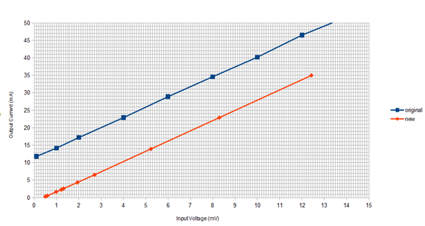

It works ok. Here's the plot I get of output current vs input voltage. This was done by hand and the points on the plot are
all a bit arbitrary. (I need to get automated like Jan.)
Like Jan, I have an offset on the current, but it's much larger - it's around 11mA. Next task will be to look at that and see
where it's coming from.

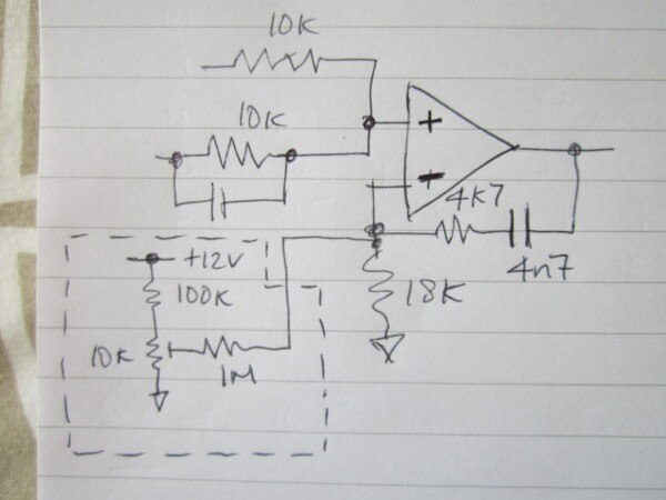

Reminder of the part of the circuit I'm looking at

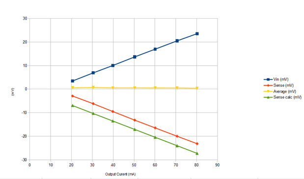

Here are some more measurements:
The blue curve is the input control voltage. This is measured at the end of the 100k summing resistor. This is telling the load what
current we want. The orange trace is the voltage on the end of the other 100k summing resistor - it's the voltage that comes
from the current-sense resistor after it has been amplified by the current-sense amplifier (which has a gain of -6.8). The
yellow curve is the (calculated) midway point between the two [note to self: I should measure this]. The yellow line is about
500uV above ground.
The green line is a calculated line. I've taken the current value, multiplied it by the sense resistor value to get a voltage,
and then multiplied it by the gain of the sense amplifier. It's where the orange line ought to be. Both lines have the same
slope, so there's nothing wrong with the gain of the sense amplifier, instead we have an offset of some sort. The two lines
are 4mV apart vertically, so if I divide that by 6.8, I get an offset of about 600uV at the input of the amplifier. It's
slightly higher than the offset at the summing node, but they're both of the same sort of order.
Next question is where is this coming from? The op amp I'm using is a precision bipolar one. The voltage offset should be
better than 140uV (that's the guaranteed maximum value, so it's very unlikely to be even that much - typ. figure is 30uV), so
that suggests it's more likely to be the bias currents and their offset. That offset is only in the nA region [30nA max - good
for a bipolar input], but with the 100k resistors used in the circuit, that translates to voltages up in the mV area.

I've replaced the 100k/680k resistors used to define the sense amplifier gain for 1k/6k8. That leaves the gain the same but the currents involved are now much larger than the bias currents and their offset and that should remove them as a factor (on the sense amplifer, that is - there will still be an offset from the same cause on the integrator).
Here are the measured results. I've put the original curve on there as a comparison.
I'm now in the very fortunate position that, as well as getting me down to the area below a milliamp on the output current, there is now a positive offset on the control voltage that looks like it more or less matches the DAC output floor which can only get to within 400uV of ground. If I'm lucky, that will enable the DAC to get the output current down to zero. I'll find out when I try it with the DAC.
Slow progress, but I've now done a bit more.
I've connected the DAC to the output board and taken some readings at the bottom end of the range.
[This is with the DAC/ADC board running from the 5V supply from the analogue board and not the supply from the processor board.]
Here is how it performs. Remember that the DAC is 16 bits, so the range of values is 0 to 65535.
Unfortunately I wasn't lucky and I still have a minimum current above zero where we hit the floor of the DAC output (it's not very
clear from the graph but the minimum current now measures 0.81mA).

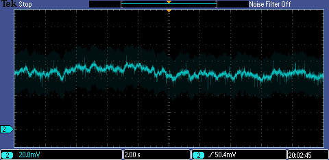

The current isn't very stable and wanders around by about 100uA or so. I had a look at the DAC voltage where it reaches the
analogue board and it looks like this. That's for a DAC setting of 100.
Although it doesn't look very nice, much of it is high frequency noise that the loop can't follow anyway.
If I look at the output current (I'm measuring it with a x1 voltage probe across some resistors) I get this
That's with a resistance of 43.7 ohms (bit of an odd value - it's several resistors in parallel to get the dissipation up a
bit). The scope channel has an offset of 250mV applied to bring the signal down near the base line so I can increase the gain
and see the variation in more detail. One vertical division is 5mV and is equivalent to about 115uA. So that corresponds to
what I'm seeing on the ammeter as it fluctuates. The horizontal scale is 4s (yes, 4 seconds!) per division, so it's very low
frequency noise. It's in the region where flicker noise would dominate a conventional op amp's noise, so is that what I'm
looking at here?

Recently, Jan used an op-amp so that he could use a second DAC output to lift the zero level above the
bottom of the control DACs range (the op amp on the DAC's output doesn't manage to quite get all the
way down to 0V, which isn't too surprising).
I decided I'd do it a different way and simply offset the integrator. Here it is as a schematic
and here it is wired to the board
That lifts the voltage that the summing node is being compared to slightly above zero.
I adjusted it so that the cutoff comes around 400 on the DAC output. Here it is on a graph

To satisfy myself that it is the flicker noise I decided to do a small experiment. I adjusted the load to give an output current
of around 600uA and captured the output on the 'scope. Here's the trace (the probe is across a 100R resistor in series
with the current output, so each 20mV vertical division is equivalent to 200uA).
I then soldered a 20M (2 x 10M in series) resistor across the integrator capacitor
and this was the result
The effect of the resistor is to cap the gain at frequencies below 1Hz, rather than let it continue increasing. It means the
very low frequency components of the noise don't get excessively amplified and we can see the result of that in the trace
where the 1Hz components are still there but the lower frequency components are reduced to a more natural level.
I called this an experiment because it's not really a solution to the problem. Having a good level of gain is necessary
both to get the output up to the MOSFET gate level and to close the loop with only a small error voltage at the summing junction.

    ok, issue fixed. I have modded the control circuit so many times that the pcb gets a bit rough. The approach works. I have connected DAC B via a 3M3 resistor to the + of 3C. The offset of the DAC at value…
    Jan Cumps over 8 years ago +5
    (The pin 1 indicator is a line of silkscreen running down the side of the pin but it's so close it looks like it was cropped back by the board manufacturer. Yes. There are inconsistencies in how pin 1…

    jc2048, where did you put that shunt to measure the current? In series with the current sense resisitor.
    Jan Cumps over 8 years ago in reply to Jan Cumps
    I see a low frequency artifact too. Almost sinusoidal, 10.5 seconds
    without cursors:
    Probe X1, over the circuit's sense resistor of 0R05, DAC set to 2000, Input voltage 5 V, current drawn 225 mA
    edit: may be related to once again a bad contact - the PCBs and connectors really start to suffer from frequent changes.
    Firmly reset all connections. Now the measurement is more reasonable:
    11.7 mv over a 0R05, 234 mA, close to the 224 mA that my meter reports.
