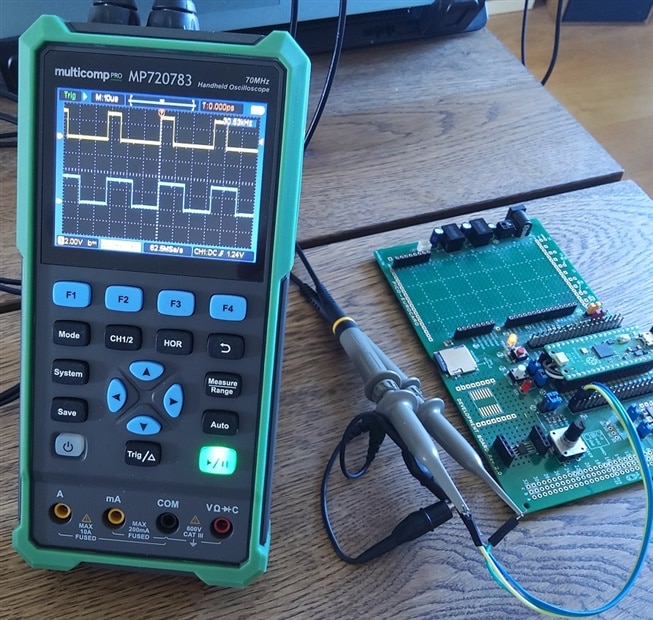

    It is now Turing Complete Grinning - can flash an LED
    Jan Cumps over 3 years ago in reply to shabaz

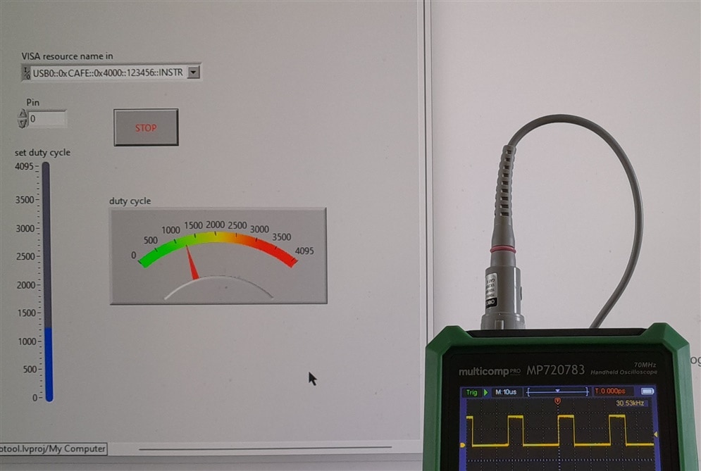

    Test from LabVIEW:
    The slider on the left uses your SCPI write to control the duty cycle. The gauge uses the SCPI query to get the value back and display it.
    Meanwhile, the oscilloscope shows what's happening at the pin 0.

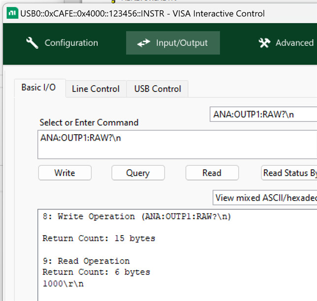

    Generating a variable duty cycle output is now available in the development branch. Developed by shabaz (pull request).
    Example commands, set and get the duty cycle of a PWM output:
    ANA:OUTP0:RAW 2000
    ANA:OUTP0:RAW?
