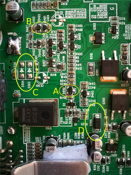

Hello,
I'm trying to repair my nissan car radio model: Clarion BTS33
The problem began when the fuel volumen line of my car shortcircuited with 12V.  As soon as that happened my radio turned off and never came back again. I sent the radio with some folks to repair it, they replaced some ICs that were burned out but they couldn't replace one specific diode.
Right now, when I plug the radio into my car only the screen shows up but it prints nothing. Just a blank orange screen. No audio output no matter what buttons I press.
I found the cable on Amazon: https://www.amazon.com/20-pin-Subaru-Headunit-Harness-Steering/dp/B01D9K3L44
I also found the user manual of the radio: https://fccid.io/2ABGYBTS33-CLARION/User-Manual/User-guide-2150158
The only component that looks burned out is the diode D402. The diode is the same as de diode D403 so I can see the marking is "C308" the 08 is fllipped to the right 90 degress.
My plan is to replace the diode but I haven't been able to find a datasheet.
I've attached images of the radio and the circuit board. Any help would be appreciated.
Thanks!

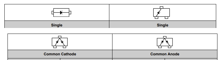

    I did not find a perfect match for the marking code. There are a few dual diodes that start with C3 (or C30). The 08 could be a date code. But in this case you are lucky that there are more diodes of the same type mounted on the PCB so you can measure if the diode configuration is either "common cathode" or "serial" with a multimeter that have a diode test.. You could probably measure directly on the PCB, or de-solder it to be safe. The diode test should also show if it is a schottky or silicon diode.
    I do think that it is enough to replace the diode with any general purpose diode that have the same configuration and type (eg common cathode schottky in sot-23 package) to see it it works.

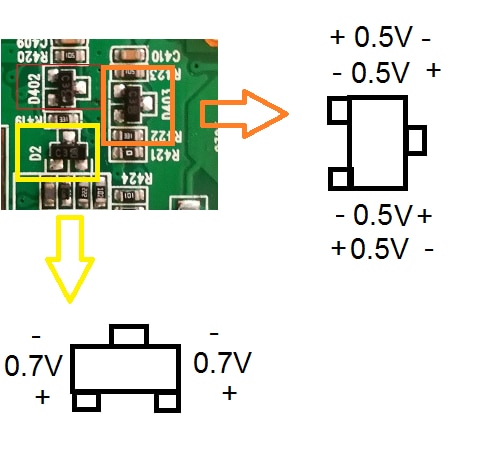

    Hi guys,
    Well I measured the 3 terminals of the diode and only the 2 that are beside each other resulted with continuity. I also noticed that the continuity is because they are both grounded. Another thing I noticed is that the marking is actually "C30B" I mistaken the B for an 8.
    Sorry for my bad diagram. So I'm not sure if this part is actually a diode at all. But as Fredrik Andersson said maybe is not worth it to replace this irrelevant part and I should be searching for something more specific.
    I think my next step is to identify every IC on the board and then try to find their specific datasheet to figure out if they are doing what they are supposed to.

    I don't wish to rain on your repair parade but, I question the suggestion the component D402 (A) is a diode. Diodes typically have two leads and not three leads as D402 has. D401 (B) could be a diode and ZD402 (B) could be a zenor diode (guessing because of the prefix Z). This two component have two leads. D304 & D303 (C) are diodes according to the symbol. Component D305 (D) might be a diode. It is fairly large and just two leads.
    There are transistors, I suspect the components prefixed with a Q,  that typically have three leads. D402 having three leads causes me to question if in fact the components is a diode. Maybe someone with SMD experience can chime in on the call.
