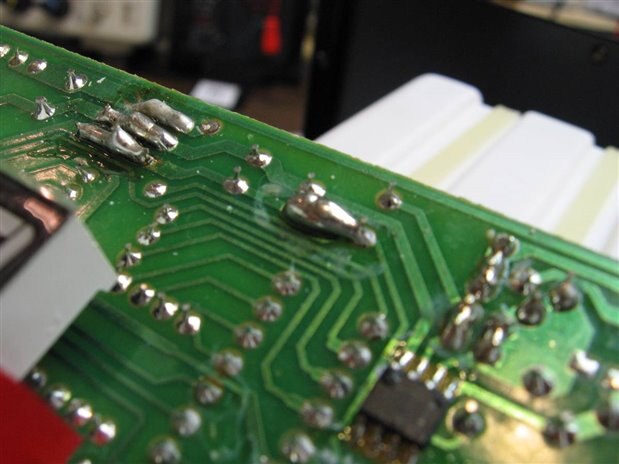

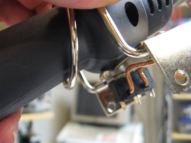

    0 jw0752 over 10 years ago
    Hi Al,
    I have the same unit 21-10125 - TENMA - HOT AIR REWORK STATION, 280W, 100V | Newark element14  that michaelwylie  has. When I got it I modified it to include a shut off in the cradle. I was pretty disappointed in the quality of the circuit board. I have seen six year old kids who can solder better than this. On the other hand, once it was modified to suit me it has gone on to work without problems for a couple years now. I do not know if this speaks to the quality of Tenma but if solder jobs like this bother you then perhaps paying a little more for quality is a good idea.

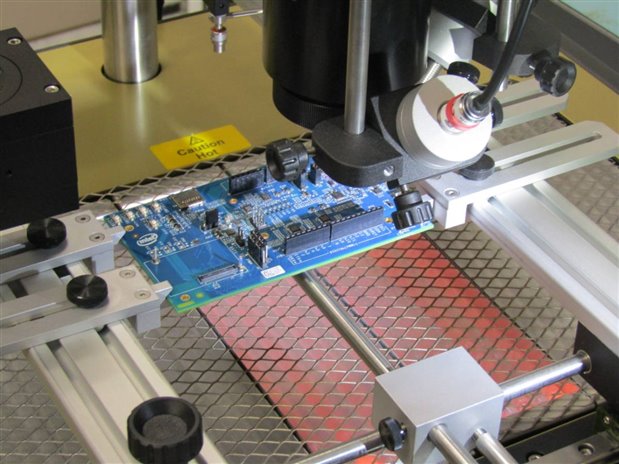

    Although out of your price range.
    For hot air I use a JBC Air Tool. It has thermal profiling output and does a fabulous job.
    For IR I use a PDR ChipTool. It does a fabulous job for small BGAs.
    As Scotty Montgomery says - "Use the right tool for the right job!"
    When using cheaper tools you'll find that the temperature regulation is absent and risk burning things and causing unwanted collateral damage.
